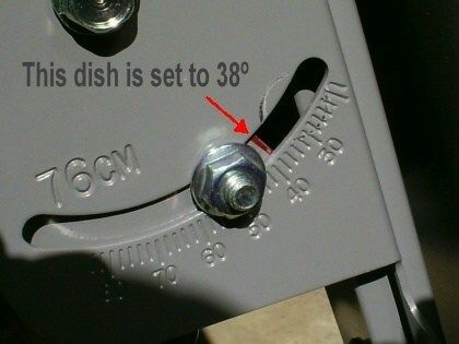

Motor should be at an elevation of 65º
Dish elevation should be at 26º
Use the RED line when setting elevation on the dish (see below)
Watch out if its a genuine SG2100 one side of the motor is marked for ELEVATION and the other LATITUDE.
Thanks for the prompt response. I have the genuine SG2100. The two different scales are on the different sides. But can you tell me why some manuals say 40- declination and some say 30 - declination? I am really curious as to why. And If you also have the winegard could you please post a pic of how you set it up to achieve that anle of 38 degrees. I understand that my dish angle should be 26 but I am really interested to see how you set yours up to get 38 deg.

I mean the SG2100 downloadable manuals some say 40 - declination and some say 30 - declination. I am confused why the same manufacturer would have different instructions. the picture that would help me is one that shows how the dish is attached to the sg2100 pole.
