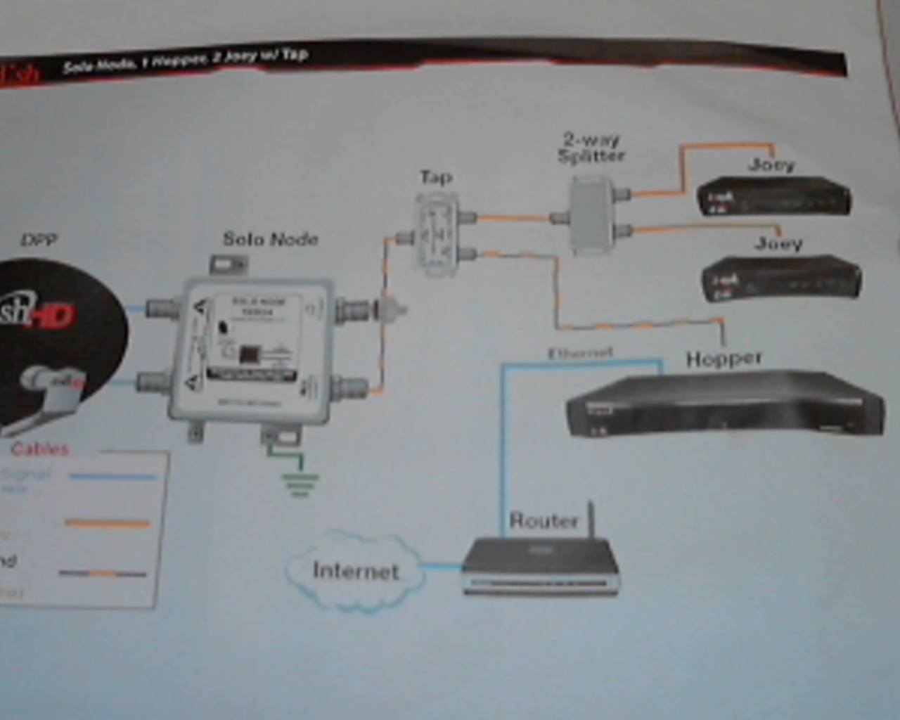

Schematics
See if this helps the standard instalation
