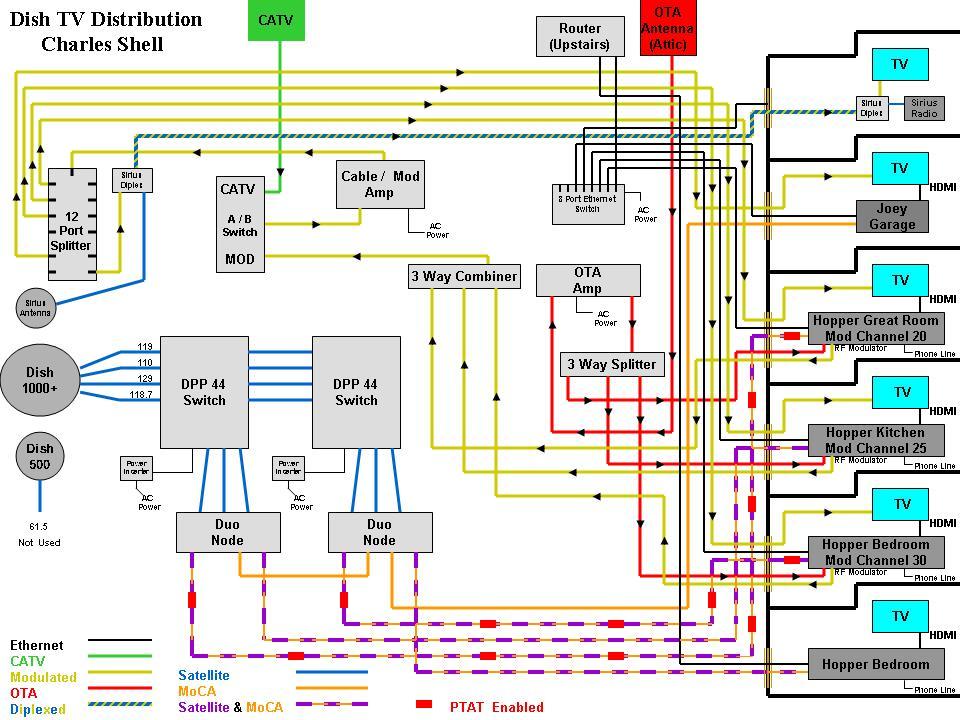

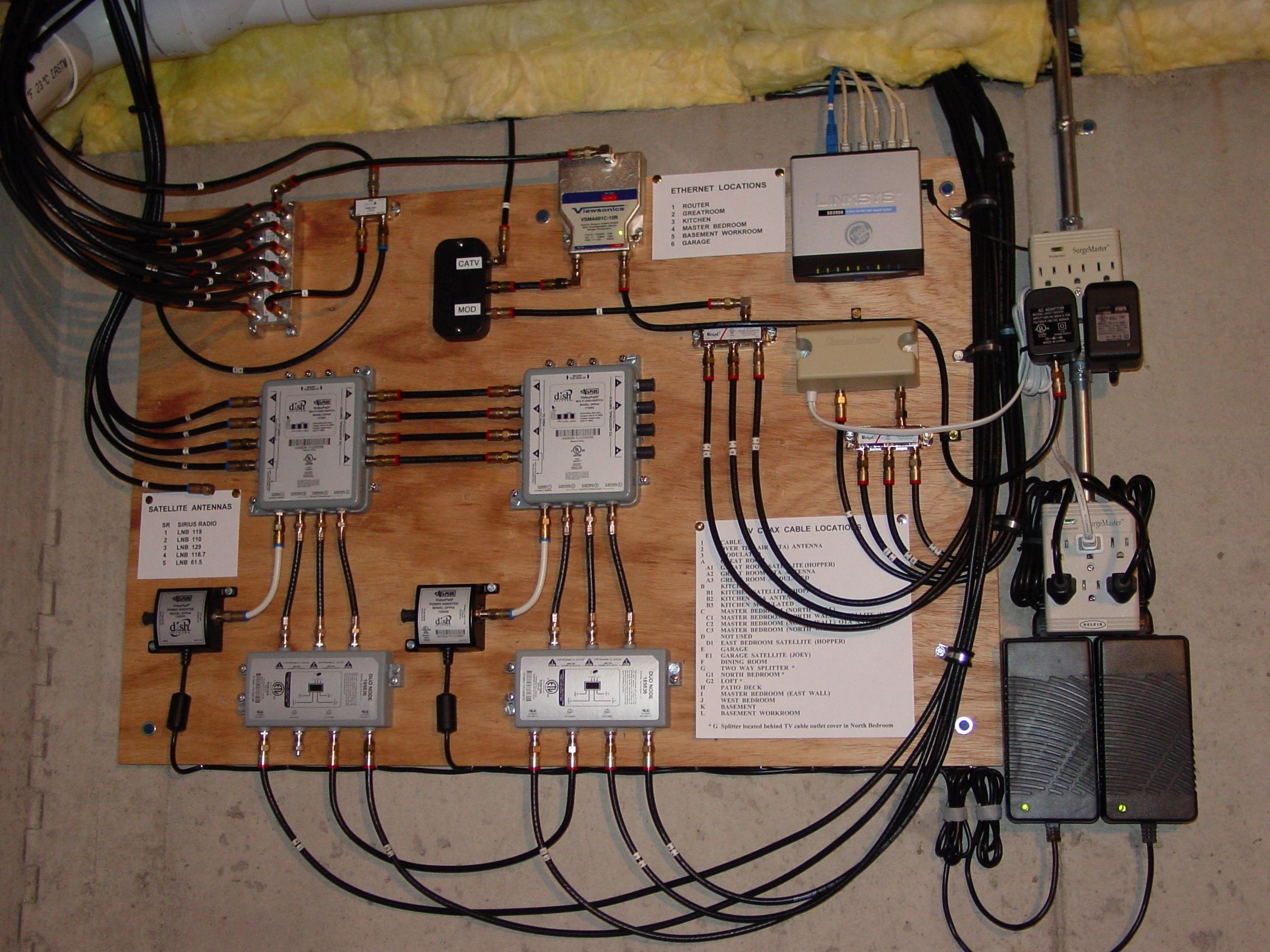

Yes, from one HWS you can see programs on every HWS. The Joey can see programs on all four Hoppers. This is possible because of a jumper coax cable connecting the two Duo Nodes. If there is no jumper coax you are limited to the other HWS connected to the same Duo Node, with the exception of the Joey. The Joey can see the two Hoppers connected to the same Duo Node. In the pics you can see the Hopper selection drop down menu from each Hopper and Joey. In the Hopper diagram pic you can see how the jumper coax is connected between both Duo Nodes. The diagram is accurate with the exception I have added an OTA module with rabbit ears to the second bedroom Hopper.
Great Room Drop Down Menu.jpgMaster Bedroom Drop Down Menu.jpgKitchen Drop Down Menu.jpgBedroom Drop Down Menu.jpgJoey Drop Down Menu.jpgHopperDiagram-PriJPEG-PTAT.jpgHopperHeadEndPri.jpg

You are welcome. Glad to help.
Definitely an UberInstallation and very, very clean. Good to see DPP44s in action again.
Is your monthly Hopper/Joey bill 4 x $10 + 1 x $7?
Tx for the pics & diagram.
Welcome. 1st Hopper/DVR Service $10, 3 Hoppers x $7, + 1 Joey x $7. Total $38.

<snip> The diagram is accurate with the exception I have added an OTA module with rabbit ears to the second bedroom Hopper.
View attachment 93695View attachment 93696
