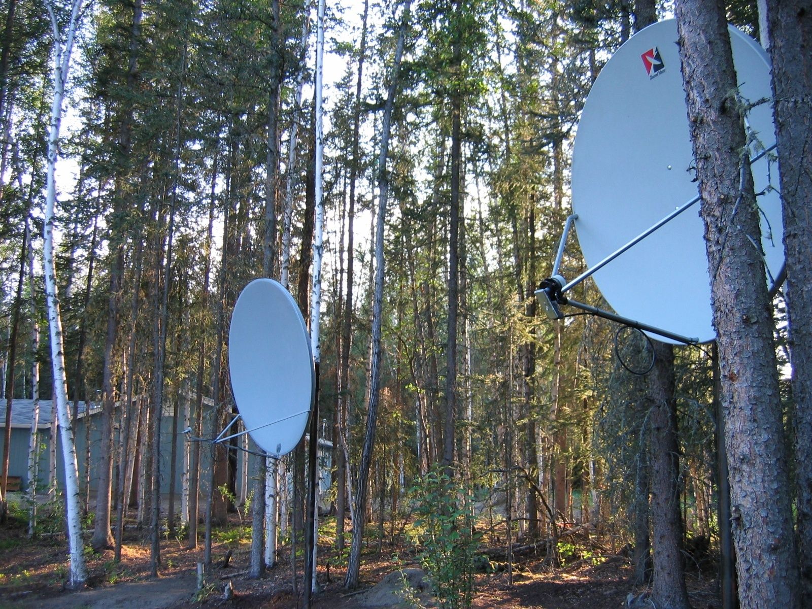

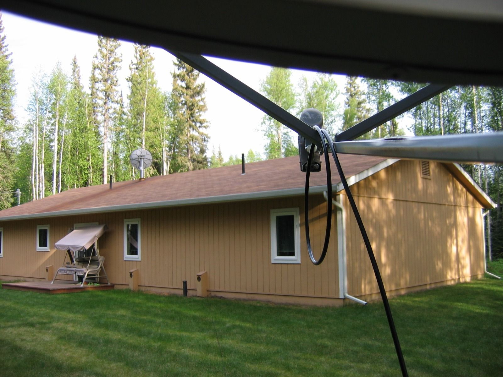

Well; it's done...
Finished up the "dish 500" this week. It's not what I was hoping for, but it's working! If you look at the picture, in the foreground is the 1.8m getting 110W through the gap in the trees. On the roof is a 1m dish getting 119W through the same tree-gap. It's all feeding a DP34 down in the crawlspace.
I'm not fond of screws in my roof, so I'll be pulling down the small dish and mounting it in the backyard.
BTW, the signal strength is pretty weak for E*8 way up here. Most of the transponders are getting around 60-70, TP8 is around 55, and 10 won't even lock most of the time (luckily, TP10 just has a bunch of shopping...). Once Charlie "relaunches" Dish this Fall, are we going to get a better signal from 110W?

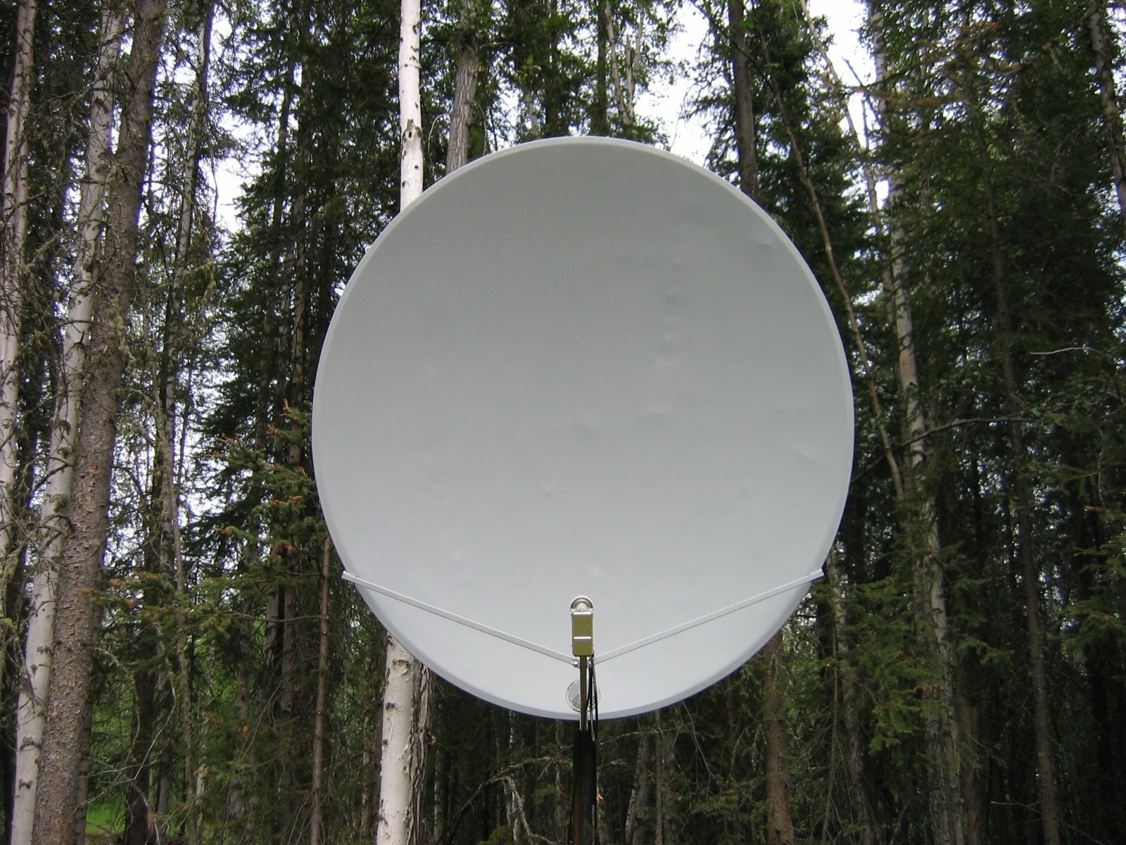

Oops, looking at the picture I feel your LNBF is not in focal point.
Can you post more pictures: frontal (0 degree) and side (180 degree of LOS ) of the 1.8M dish ? With original LNBF and Dish's LNBF ?

More photos
Here are some more shots of the reflector. Let me know if things look "out of whack". BTW, that model of dish is really popular up here, and, from about 30 feet away, they all look about the same (mine might be a little more wavy).:confused:
I see it now - looks good. But that little bumps ... no big deal, but if whole parabola dis-shaped, then signal will be low then usual. If you coud recheck 119W with it - what will be SS for all tpns ?

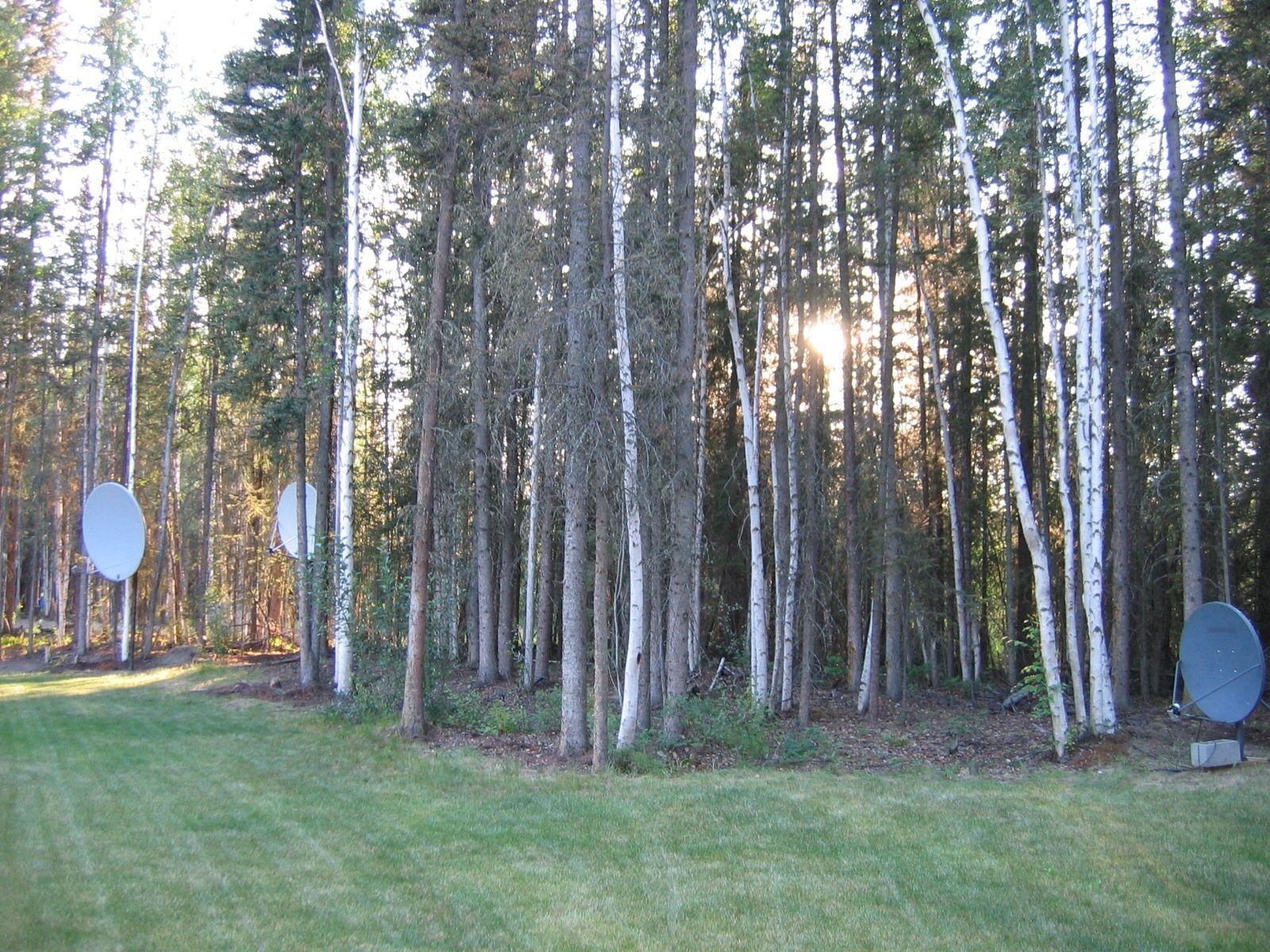

Dish 500 V2.0
Pretty busy this weekend... Some folks down the street decided to ditch E* and go with DigitialCable, so I bought their ChannelMaster 1.2M from them. It is now mounted in the backyard about 12 feet from the 1.8M. Together, the two of them are D500 V2.0! I was a little puzzled when I fired up the 1.2M and got the same relative signal strength as I was getting from the 1.0M (both pointed at 119W). Something to do with how far north I am??? The 1.0M came off the roof (nothing driven into my roof now!), and since I had a free port on the DP34, I decided to set up a Very Small Array in the backyard and point the 1.0M at 148W (our digital locals are on 148W). I must be getting better at this whole satellite-peaking thing, because I had 148 locked-in within about 5 seconds (no joke!) On the second thumbnail, 148W is the little guy on the ground (temporary mount) near the right, 119W is in the middle, and 110W is on the left. The wife thinks I'm insane to have all of these dishes in the yard, so I'm probably done for a while!;)
The low one looks like a primestar dish! ;)
Yeah; I've seen some pictures of old Primestar dishes, and the little (?) guy does look like one, down to the dark spot near the top where the sticker would go. BTW, I'm thinking of trying to turn the VSA into a Dish 500+, but I'm having a hard time getting 129W with the 1M. I figure another 1.2M would help...
