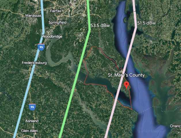

Do you know what DirecTV does for customers who live in DMAs but are specifically outside of the contours on the beams meant to cover those DMAs?
Asking since I've been to the DC DMA a few times and I did some research earlier and found out some counties aren't within the inner white-colored contour (the one with the most dBw) on the Earth footprints.
Part of one county in the DMA, specifically St. Mary's County in MD, as you can see, is just flat out not in the contours.
This is specifically the D11 A2B4 Washington Richmond spotbeam.
I would assume they either give customers only the SD versions of the locals or just flat out not give them anything.

There are several issues at work here. In general, when they install DirecTV service the installer looks at the signal levels, and with consultation with their supervisor decide on the spot what is feasible. The beam contours in our library for most satellites are from engineering evaluations of the antenna patterns of the satellite on the ground before launch. The antenna reflectors aim can be tweaked, as can the power output of the transponder. The dB levels of footprint contours were calculated from the peak power shown in the FCC filing and the contours were specified in the FCC filing as contours of -2dB, -4dB, etc. down from the peak. The contours are polygons, with just the vertices specified, and a straight tline between them, when in real life they are a smooth curve. And it is a gradient between the contours. So the point you are showing is probably getting more than a -51dBm signal, which is sufficient, if you could believe those contours...
But the real problem is that we don't have any real data for the beam contours for D11 (T11). They just were never filed with the FCC. They only filed four sample spot beams. All of the beam footprints for D11 in our library are an approximation derived by me from the D12 footprints, applying judgement and crude calculations on how the beams would translate from a satellite at 103W to a satellite at 99W, and how they would adjust the 4 main reflectors to make the spot beams land on the DMAs they serve. They are not precise enough to do the kind of analysis you are doing.
And look at the dBM values of those rings. Because different spot beam transponders have different peak power, the same color ifrom one footprint to another is not necessarily the same level. -51 dBm is good enough for Ka band, and reception is possible below that.

I need to make a couple corrections to the comments on the beam footprints above. I fired off the response when I was pressed for time, and got some details incorrect. I haven't visited these beam footprints in about 4 years, so the details are a little fuzzy. I referred to the value of the rings as dBm (dB relative to a milliwatt), when they are specified actually as dBW (db relative to a Watt). My mind was mixing up up units from some other technical work I have done. I also was using a minus sign with the values which is incorrect. So the statement should be 51 dBW should be good enough. Actually, most of the CONUS beam from D11 in the Western US is around 50 dBW.
Also, the 51.5 dBW line in that Washington beam footprint is supposed to be pink, not white. In other footprints I made the line for 8 dB below the peak more purple than pink, because the pink appears too close to white.
