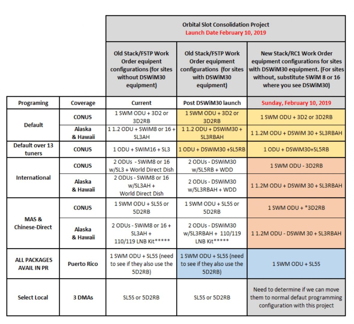

Pardon me if this has been answered already but what is on the reverse band and do I need to upgrade my LNBF to one anytime soon? Planning on keeping these HR24's for a long time...
Unless you get an HR54 or Genie 2 and 4K client, or decide to add a subscription to Spanish or international programming this year, you don't need it.
I currently have a SWM SL5, I bought my own SL5 off EBay a few years ago to get the extra few music channels that are on 119. Where will those be moving to?
So far the same as all International and Spanish TV programming on 95 and 119w. To the Reverse Band at 99w (or "99cr"). At least for the time being.
Don't know if that will be their permanent home though, but even if it were your non-RB LNB should continue to work for receiving those music channels on 119w for the foreseeable future since DIRECTV will have to keep the legacy duplicates on 95/119 up as there are many current subscribers who use them and can't receive the RB.
Sent from my LM-V405 using Tapatalk
They are currently mirrored on reverse band, but I'm pretty sure when they are dropped from 119 they will move off reverse band onto Ka so people like you with an SL5 will still be able to get them. Otherwise they would have to go to every Spanish and international subscriber and upgrade them to a reverse band LNB which would cost millions. So I wouldn't worry about it.
