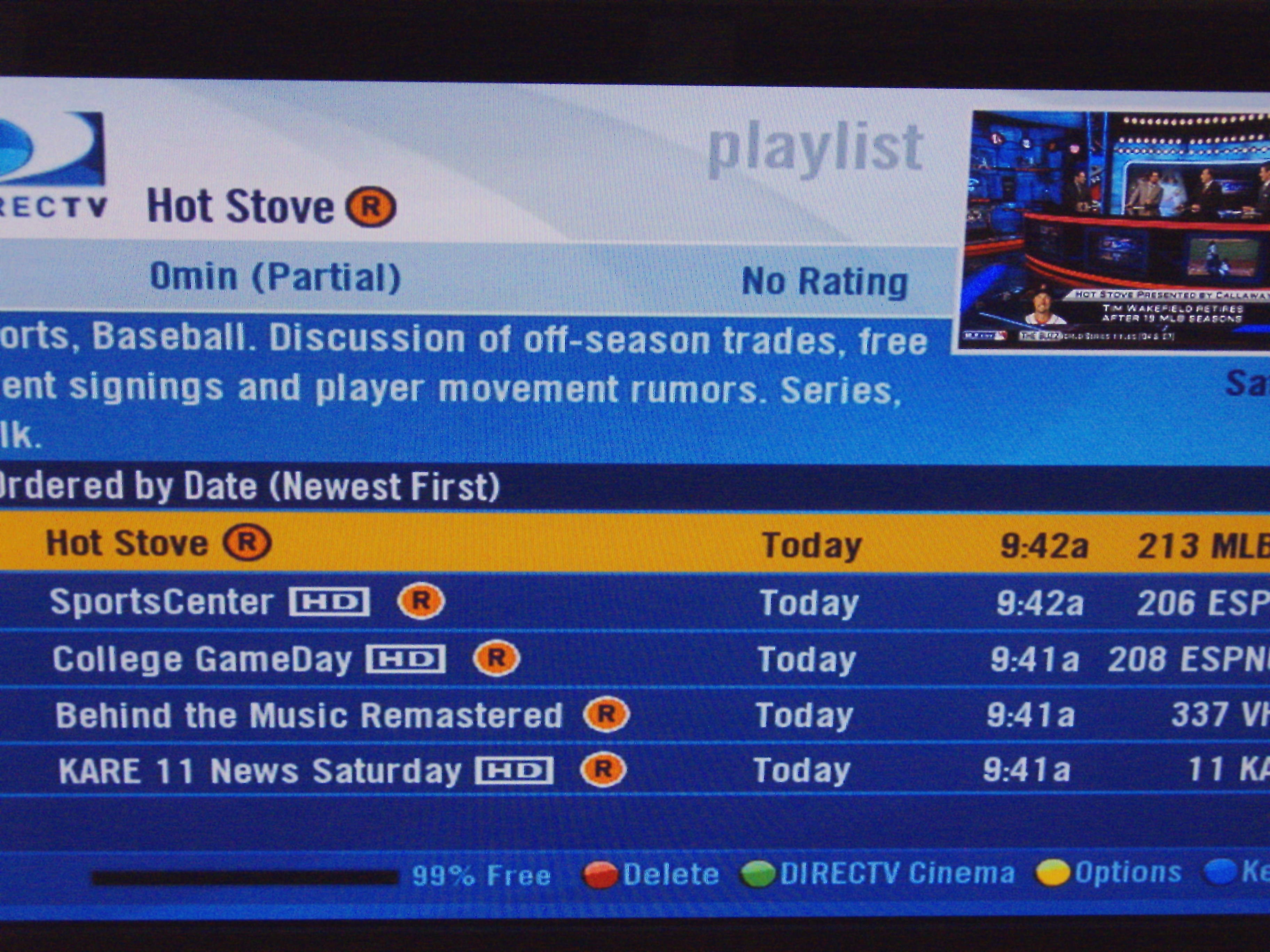

I know I've seen pics before but to quote Butt-head (of Beavis and Butt-head)
"This is the most beautiful thing I have ever seen"
