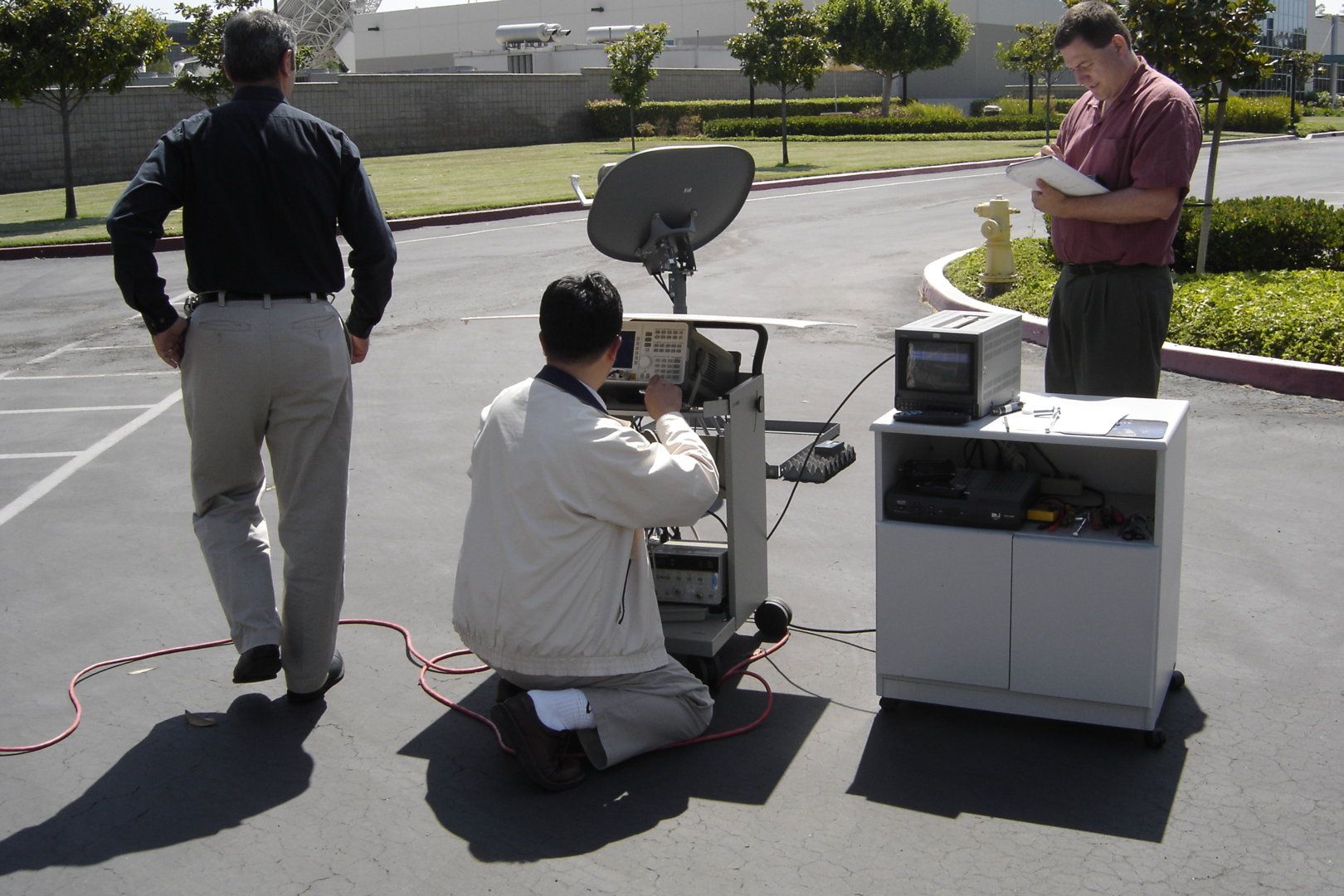

If you connect a spectrum analyzer to the coax coming off an LNB then point the antenna from the sky to the ground you will see a noticeable increase in noise when pointing at the ground. A similar thing happens when the dish is looking down a wall or roof at a slight angle below the satellites, the side lobes of the antenna will see the "hot" roof or wall and the noise floor will increase and the signal to noise ratio will be degraded. This will eat up some of your headroom for rain fade, mis-pointed antenna, etc.
If someone is experiencing excessive rain fade I would first peak the antenna just in case it was not installed right or it moved over time. I would also see if its got any wall or roof line within 20 or 30 degrees of the line to the satellites. If its on the back side of a roof with the LNB arm running parallel with the roof line then move the dish and let it breathe.
In fact, here is a picture of DTV engineering testing this exact phenomenon, taking data on a clean shot to the satellite and with "hot" items in the sidelobes using a prototype AT9 dish.
