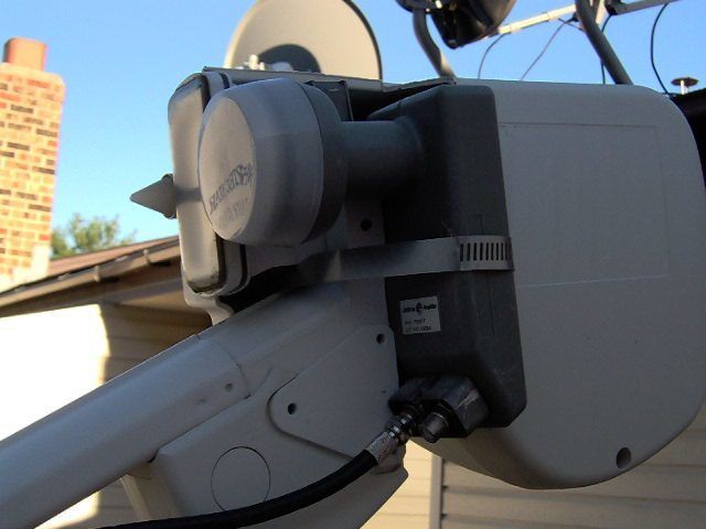

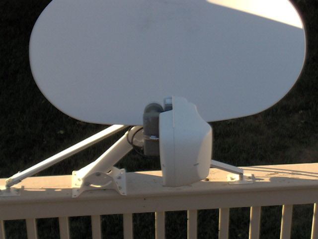

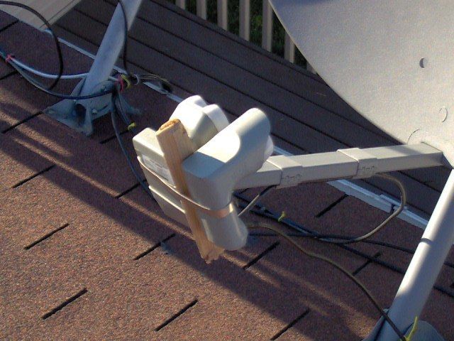

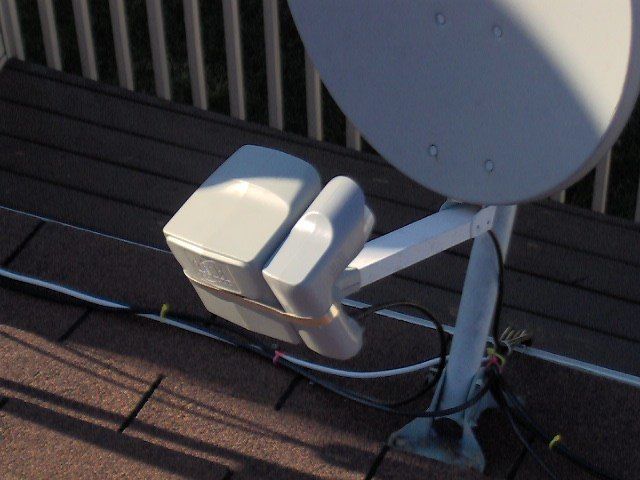

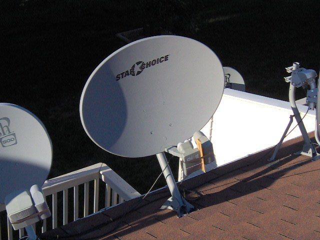

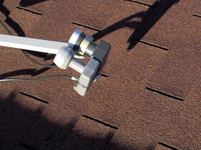

Here are some examples of 2 LNB's on one dish :)
The metal piece is the hose clamp
All of these at one time were on my roof setup. A few have departed (switched stuff around) :)

yes you will have to deal with 2 recevers (since they work different) but it can be done on one dish. BVN is free so any free to air receievr will work. :)

Iceberg, nice collection of dishes. :D When you get a chance, take a group picture of all the dishes on your roof and post it here. To us satellite dish fanatics, the more dishes on a roof the better :devil: It tells us a true hardcore satellite enthusiest lives here.
