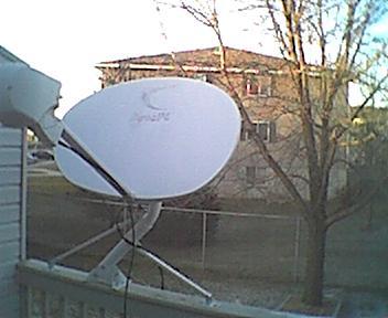

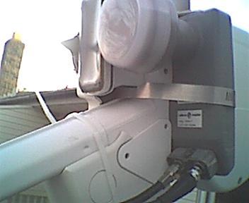

yes that LNB will work fine...the rectangular one will work for KU. There is a pencil LNB next to it and that is DBS
Here are some bad pics of my DPC dish....the LNB added (closest) was when Expressvu (91W DBS) had the audio channels in the clear. They havent been for a few years now :(

If you take that plastic shroud off the back of the LNB (there are like 5 screws) it should be on a red sticker. But it is standard/single and 10750 LNB LO
