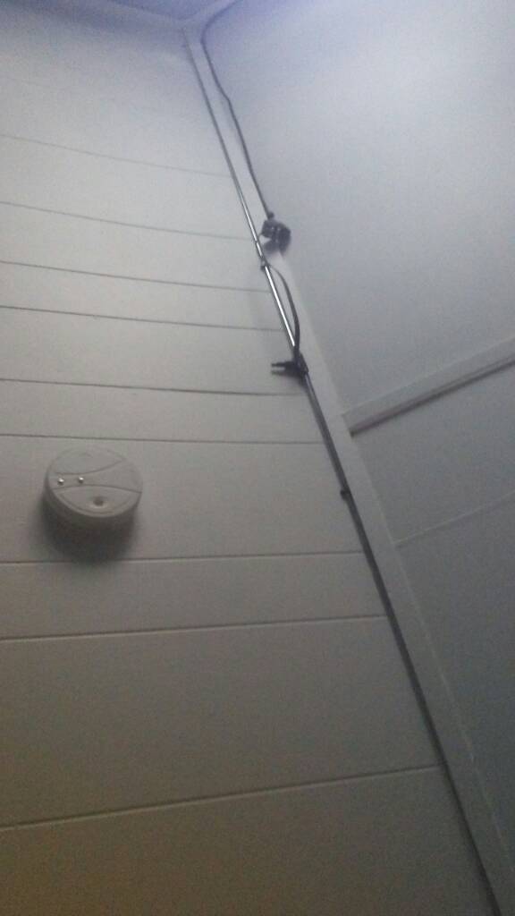

Yes, I live in an isolated city that only has 3 tv channels (0 sub channels), all are were cut live to digital on the Canadian digitital transmission date at noon. I watched on my analog tv when they switched. All I got was snow after the flash cut.
Now that I have a new tv and still use my rabbit eats to get my locals at 2, 4, and 9. All real frequencies.

A pic of my rabbit rars attatched the the ceiling of my 3rd story apt.
