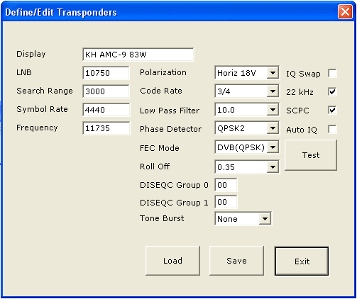

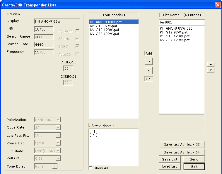

I guess it would be easier to show some pictures
Those are two screen snaps from the editor and the pages from the instructions that explain what all the options are. If you click on them they will open up to full size where you can read them. :)
Now, after a whole lot of reading and re-reading and with advice from my neighbor, I THINK I have made my own files for it.
At the bottom of I've attached two screen snaps of what I THINK the settings for AMC-9 should be to cause the birdog to tune in specifically the channels with RTV on them and no other channels.
From what I gather, you must have your dish very, very precisely aimed at that one little weak satellite or the big bully satellite drowns it out.
How I ever found it before is beyond me. There really is such a thing as dumb luck and beginners luck. I had them both.
Ok, so you guys that are the true experts here, the rocket scientists, please take a look and tell me what you think, do you think I have this all set right?
Oh, my neighbor did say that "the birdog probably wasn't working with the direcway dishes because it wasn't sending them the 22khz signal which they require."
I'll take his word for it. He looked at what I made in the editor and he says it looks ok to him and that I should go ahead and try it, that it can't hurt anything.
But if it's wrong, I could spend hours out in the hot sun. I really would prefer to not get burnt to a crisp, it's well over 100 out there. So I'm hoping that you guys can look over these things and see if I have them right and save me from becoming a wilted flower, again. I already spent weeks out there last time with these kooky things.
Thank you! :)

It is not "another satellite in the same spot that's hijacking the channel". That Video 1 channel is on the same satellite, and it's not blocking the RTN transponder, and it is not significantly stronger, if at all. There is very little difference between it and the RTN transponder.
It's just that that Video 1 transponder is near by the RTN transponder, and your receiver, for whatever reason is picking it up instead of the RTN channel.
Aiming your dish better MIGHT help a bit, if the signal strengths are marginal, but normally, if you can get the Video 1 channel, you're probably good enough to get the RTN channel. It's probably just some wierdness of your receiver, coupled with perhaps a freq shift of your LNB, that's causing your receiver to lock onto Video 1 instead of RTN. Some people have had luck by using a slightly higher freq for the RTN channel, instead of 11735, or you might try changing your LO freq setting to something like 10749.

The only small thing is, BirDog can NOT communicate with any dish, since its just a peace of plastic or stamped metal, hence you really need to know your LNB type and specs to select proper options in BirDog software. Unless BirDog is directly hooked to the LNB, you need to indicate proper DiSEqC Switch port(s). Do you have any switches on your Dish, the LNB is hooked to? Another minor point, your neighbor missed, you're already watching the sat, there's no reason in the whole world to re-aim your dish, as B.J. pointed. The most sad outcome goes back to Melgagra's post above, which in familiar terms explains, how to change parameters of RTV channels in your PC Sat Card software to finally get back that vanished childhood dream RTV. If you don't see RTV channels listed in your PC Card Soft after Blind Scanning the sat, add them manually. Also keep in mind, fine tuning the dish and playing with BirDog might not relieve you from duty to do the above adjustment testing thing with channel params in your PC Card. :D
dee, make it easier on yourself, order a stand-alone receiver (like the Mercury2 or Traxis 3500) that you can carry out to the dish and tune with. Drag the extension cord and a little tv with a short piece of coax to hook up with, and I'll bet you can get your RTV back. A bigger dish would help, but I've gotten that channel just fine on my direcway dish before with no big problems.
You can check the plumb of your mounting pole with a level, to make sure it didn't move in the ground. Check all around it to be sure. If you can work an iphone thing, I know you can read a level!! Good luck.
