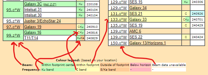

Thanks, yep, I looked at Lyngsat and boy is it confusing.
What's confusing?
Left column is based on your location derived from something (IP address, browser, I'm not really sure)
Pink is below the horizon and orange means you're outside the footprint, so you likely can't get those.
Green and yellow are things that in theory you should be able to find. White is a toss-up.
Third column tells you which bands are available: Ku, C or other.
Then you click on anything for more details of what is available on that sat.
In the example I posted, Jupiter 3, Galaxy 34, AMC 6 and Galaxy 13 have no frequencies listed in the third column, meaning there's nothing there. Also: 133 is yellow and 99 is green, so theoretically I should have a better signal from 99.
