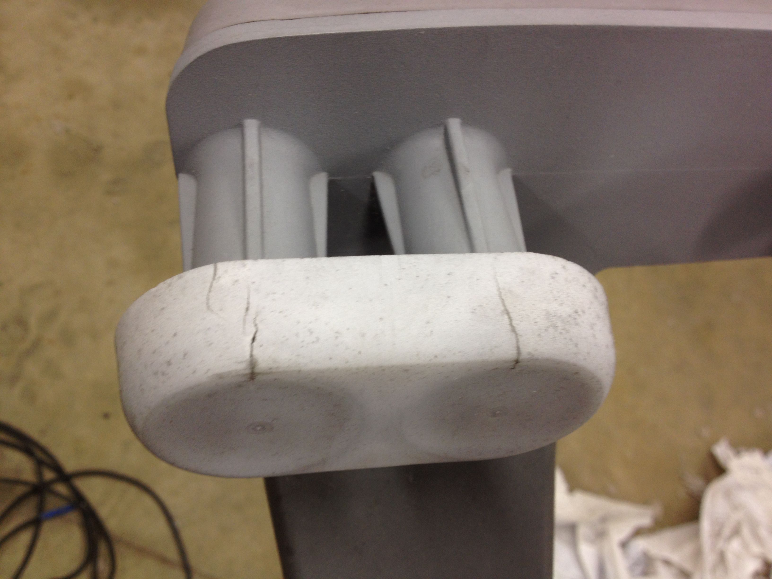

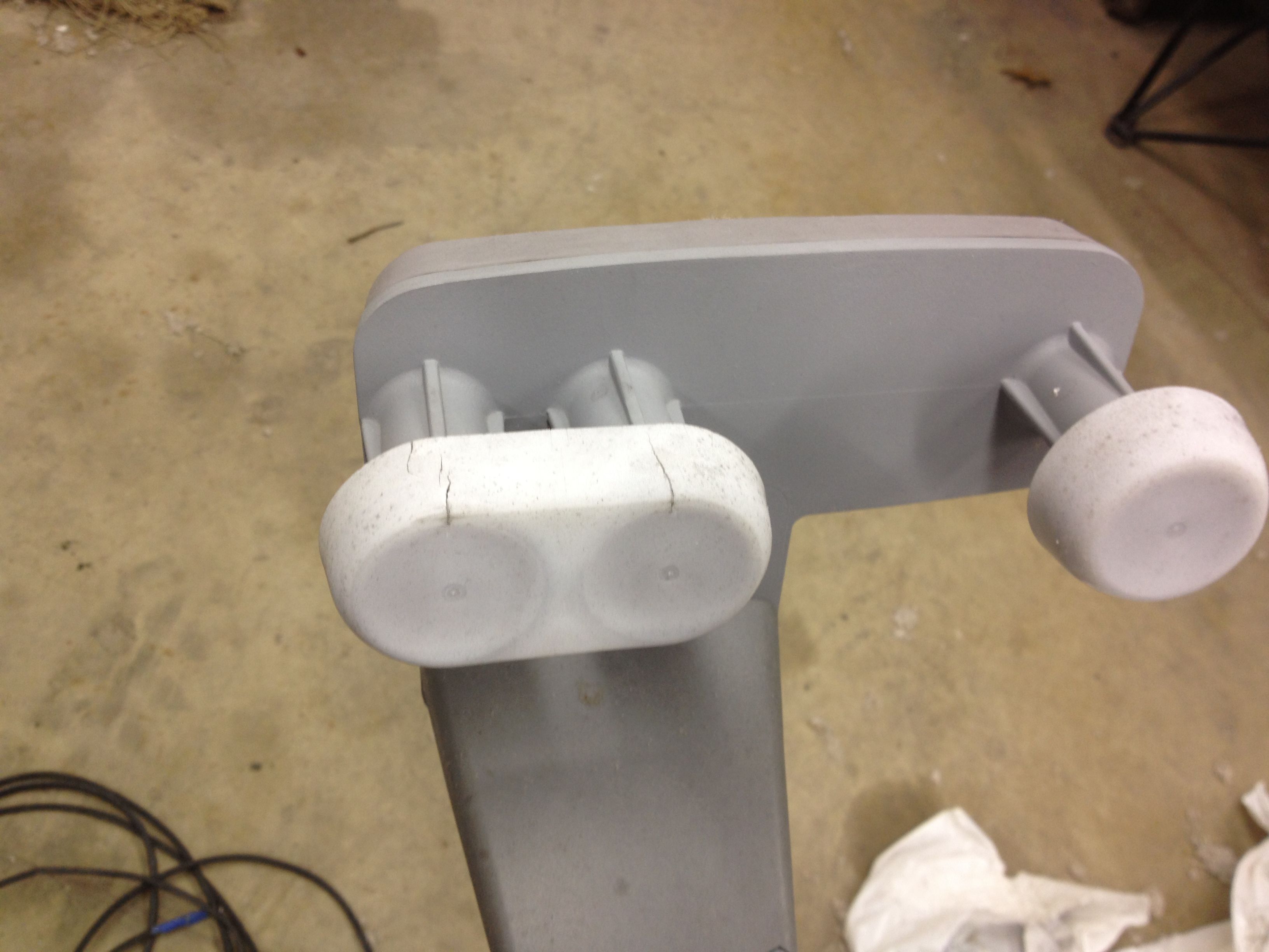

Trying to fix this for a friend. Any recommendations or should they get a new LNB?

I had one sort of like this. Custy had no signal because the cup had water about half way up. I drilled a small hole to let the water drain. Then used silicone to seal the drilled hole and the offending crack in the top of the cup. Signal returned perfectly.
Why not leave the bottom hole open?
What new water ? If you repair/seal the cracks properly, you don't have to worry about more water getting in. :p
What about insect life? Not as bad as the old "C"band days when you could uncover the LNB and find a beautiful wasp nest with angry residents.
Another possibility is several coats of clear Fkexseal. My wife broke a bowel from a fountain in half. After I used contact cement to put the 2 halves back together, I used Flexseal to seal the crack. Just like the TV ad, it works.
Nah, this was small bowel from a cascade fountain. About 4 in inches in diameter. She was weeding and accidentally knocked it off the stand. And of course, a replacement was no longer available.
Just put a bag over it. Clear or black. It won't affect the signal. Our local Spanish-speaking friends have been doing it for years. Only foil will block the signal coming in. Or your hand (water content in your hand). I used to experiment with cardboard, paper, plastic, etc, and the signal will still pass through all those mediums with no affect to programming inside. Or as others have posted, use some silicone. If there is no water in there now, the crack will have no affect on the signal coming in to the lnb.
If it's not cracked on the bottom you could try popping it off and flipping it around so the cracks are on the bottom and not the top and then silicone them up. Of course, it may fall to pieces if you try that, they don't usually come off easy, but being cracked already, that one might.
The bag idea that Jarvantgroup suggested works, I did that for one that had no cover for a few months until I was able to get one, wrapped the bag around it tight and taped it.
