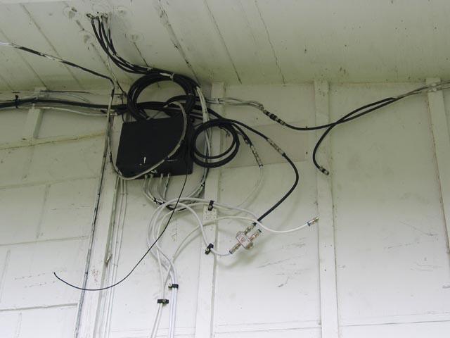

One thing he was right about though; the SW64 can not do DisEqC signalling, which is needed for the separator to work. I don't know how many tuners you have, but the SW64 would still serve if you'd run another co-ax to the 722. Sounds like you already have two lines to the 622.
These days we install a 34 switch, which still can't pass DisEqC, but it can be cascaded to 8, 12, or 16 outputs. The 33 switch can pass DisEqC, but has only just come out. And the 44 can, but is expensive, requires power, and is mainly used for internationals + HD. (4 inputs)

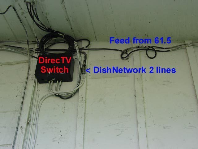

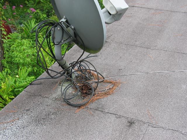

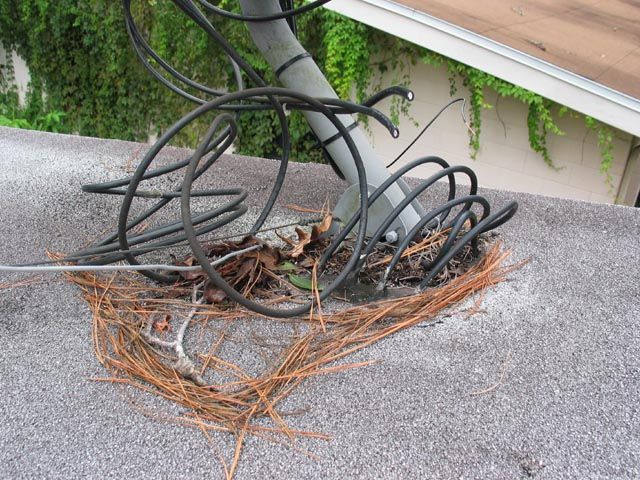

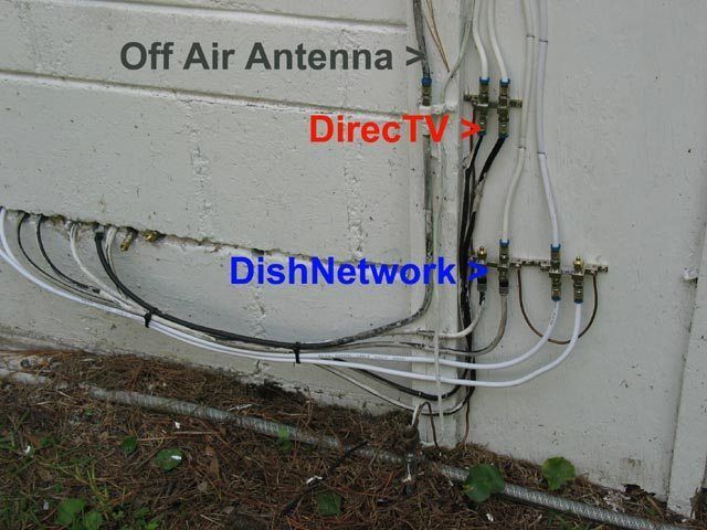

Yeah, thanks for the comments. Here are some pictures of his work and a few after I spent an hour today cleaning up. I still don't understand why he stuck that splitter and fed back to the TV2 output on my 722. I didn't get a picture of the SW64 switch but you can see where it used to be next to the DirecTV switch box.
There are 2 cables for the DirecTV and 2 for the 622 (old) plus 2 for the New 722. These are white. I see the New LNB Dish PP has a place to connect the 61.5 Dish LNB andnow I only have a single feed to each of the Dish DVR's. There is a satellite splitter that came with the receivers now connected to each of the 622 and 722's sat inputs. Don't need the 3rd and 4th cable anymore so I put a cap on the arrester block to seal them off. I also used to have 2 more cables for a second HD receiver for DirecTV but these are also capped off. I also noticed none of the connectors were screwed on tight, Just one turn or so.
He didn't understand either...
My gosh, what a mess. The co-ax should have never, never been put through the roof, and ground blocks must never, never be mounted vertical. (rain) Over time this will corrode, get intermittent, and fail.
Don't worry, he'll get QCed sooner or later, and will get charged back $150 for each failure. However it won't fix the core cause.
