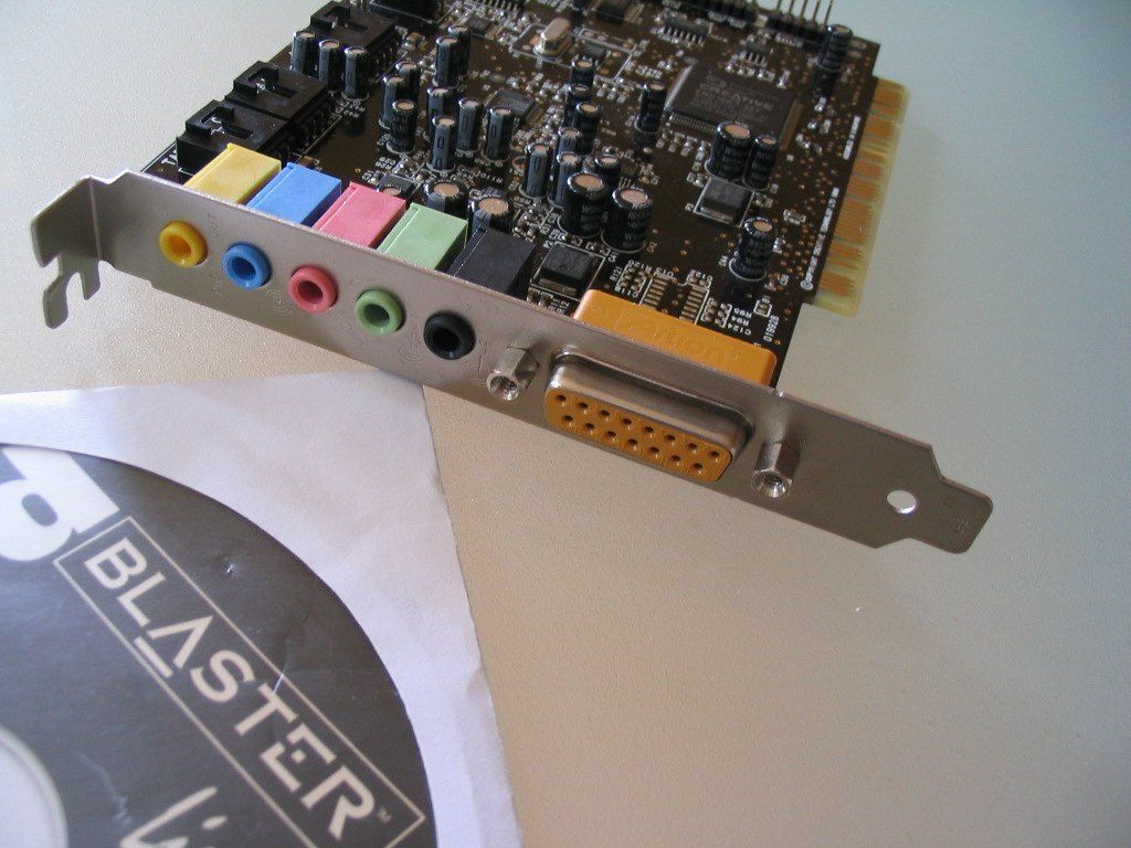

You are correct; stay out of the mic jack. Is this your jack panel? So it should be BLUE.
EDIT: Well I was trying to up the manual top, but the U/L keeps bombing.

I got home and I tried the blue input and that was it! I also had to change the "audio properties" so that it now takes line in. Thanks again guys! Now, I just need a better tape player!:D
