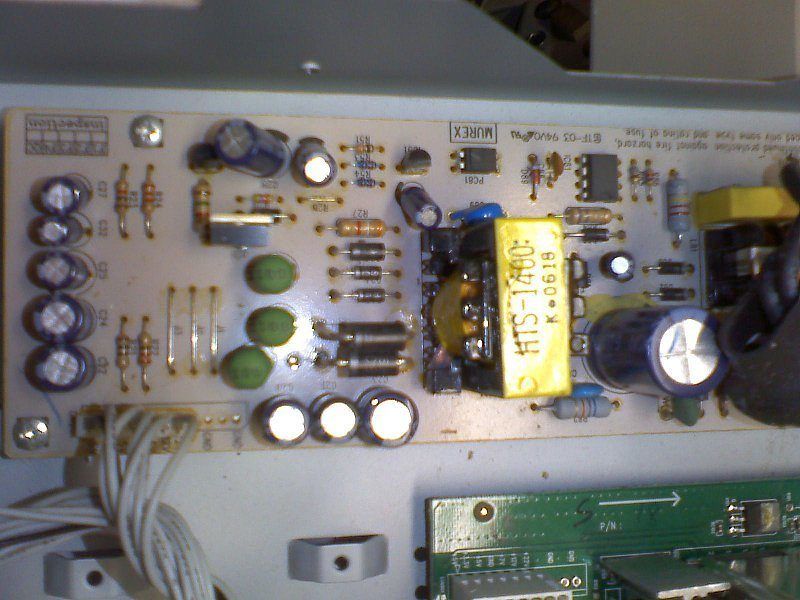

I agree with sergei. I have been a Certified Electronics Tech since 1973, and have similar experience in the field. Clean DC voltages are essential for proper operation of digital circuits. Capacitors may not fix the problem in all cases, but since they are cheap, it is the easiest thing to change that may produce a positive result.

As long as the boot section is still intact,it can be recovered via serial port.If the voltages are good I wouldn't waste time rebuilding the power supply.

Your talking apples and oranges here ....as your talking software versus hardware and I'd bet you still had a display of some type showing which says the CPU was still functioning at some level. He has no display which means the CPU is no longer accepting data and from his first description of the problem points me toward a capacitor going out and whether it's on the power supply or main board can only be determined by his measuring the voltages.
As far as repairing the power supply it's a simple one layer switching unit which most people could repair. Replacing capacitor on the main board would just need more care but can be done without damaging it.

no led display and no display on tv,which corrupt firmware would do.I would hook up a terminal program to rs232 to see if there is any action,then proceed from there.
Thanks to all for the advice and thoughts. I changed out C21 and one next to it. It came back to live and is doing fine so far. I'm running 10 fta receivers off 3 10's dishes, some receivers are getting old so replacing caps in power supplies may be come a frequent chore.
