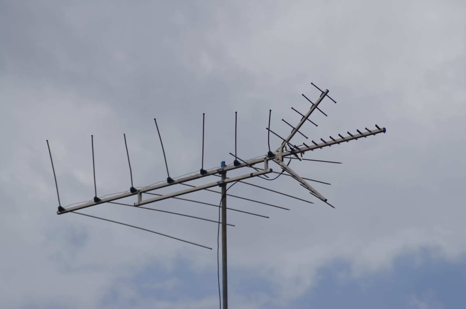

Since VHF-LO is not used anymore I would like to trim down the VHF-LO elements on my antenna to convert them to VHF-HI.
How do I calculate the correct length they need to be trimmed to?
The antenna was designed with all elements intact, cutting some off or removing them might make the performance of the overall antenna worse.
For a quick test without permanent damage you can unbolt and completely remove the back 4 reflectors. The crossover wires on top are attached to the front with wing nuts. Completely remove the lower boom and move the mast forward for better balance. If you get the desired results I would shorten and reinstall the lower boom for permanent mounting. I did this with the front of an old vu-190 and it works great.
It looks like a Radio Shack VU-120 which probably has 6 or 7 db gain on VHF-Hi. The problem is that it is a log periodic design and was designed a certain way to cover both bands. Trimming or removing elements could really screw up the gain profile.

I need access to BOTH VHF-HI and UHF. I am in the Dallas market and CBS is on VHF 11 and ABC is on VHF 8. CBS does have a UHF clone feed but ABC is VHF only.
The ideal replacement ain't cheap.
http://www.solidsignal.com/pview.as...tion-VHFUHF-HD769-Series-TV-Antenna-(HD7698P)
Well, if it ain't broke, don't fix it. Not going to mess with it for now.
