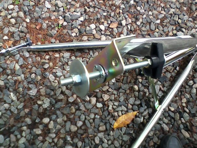

If you're at all handy, a low cost roof mount dish tripod can easily be modified for portable use, complete with adjustable leveling legs. I paid about $25 for my tripod, and about $12 for the additional hardware to make it easy to use and level. The post is permanently clamped in place at the bottom, and slides up and down as the tripod legs are extended or retracted, locking in place with a single threaded hand wheel at the top. Leveling is done with 8" threaded carriage bolts at the bottom of each leg. The bolts are fitted with large wingnut handles for ease of adjustment, and the other ends are fitted with a large fender washers to prevent sinking into soft ground. The original swivel feet on the legs have been fixed in place with a couple of pop-rivets, with a threaded insert riveted through the bottom for the threaded bolts. In the ~8 years we've used this setup, I've only needed to use a wood block or two under one leg because the slope was beyond the range of the leveler screw perhaps 3 times out of hundreds of set ups.
