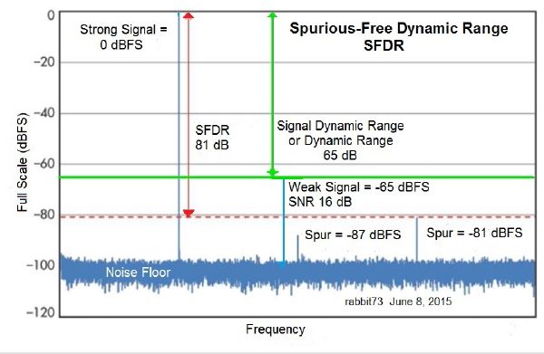

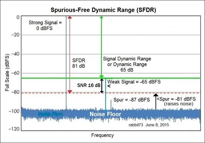

Spurious Free Dynamic Range
The Spurious Free Dynamic Range needed is the difference in strength between your strongest signal and your weakest desired signal, plus 16 dB for the SNR of the weakest signal, using the dBm Pwr scale on your tvfool report. This difference is expressed in terms of dB, not dBm, because the original units are the same. The difference between the strongest signal and the weakest signal is the Signal Dynamic Range/Dynamic Range, which is 16 db less than the SFDR, because it doesn't include the SNR of the weakest signal.
Another way to think of SFDR is from the top of the strongest signal down to the bottom (noise floor) of the weakest desired signal. The top of the spurious signals must be at or below the noise floor of the weak signals if they are not to cause interference. The Signal Dynamic Range is from the top of the strongest signal down to the top of the weakest desired signal.
You can also use the Noise Margin or Signal Margin scale for your calculations, but I prefer to use the dBm Pwr scale because most tuners drop out around -85 dBm.

With the LNA200, it is necessary to insert the attenuator before the preamp to keep it from being overloaded. Even a small amount of overload will produce IMD that will create spurious signals that will raise the noise floor and reduce the SNR of RF21. I redid the SFDR diagram to make it a little clearer, I hope:

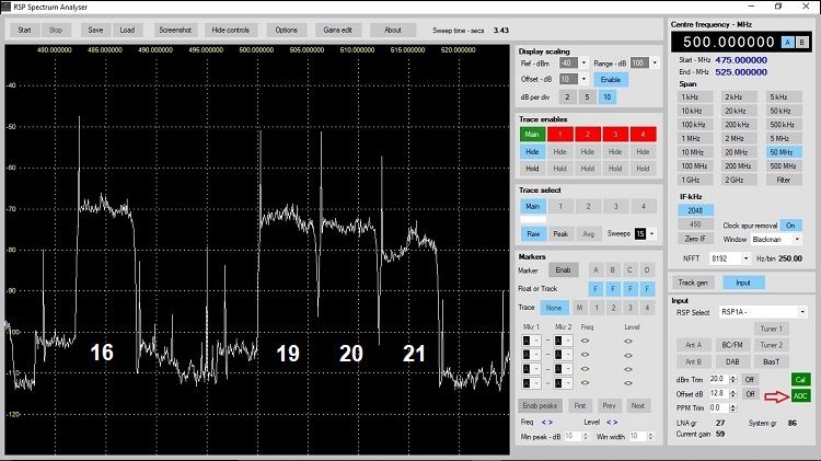

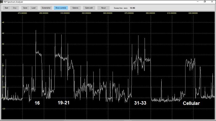

I'm still curious to see what the channel 21 signal looks like on an SDR spectrum analyzer scan. These scans were with an SDRplay RSP1A SDR ($100) and RSP Spectrum Analyser software:

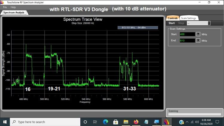

You can also use the dongle with the free Touchstone software which covers more than one channel:
Touchstone — RF Spectrum Analyzer Software

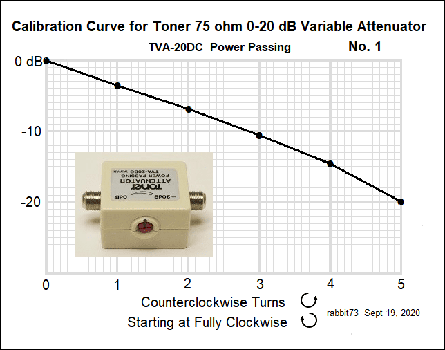

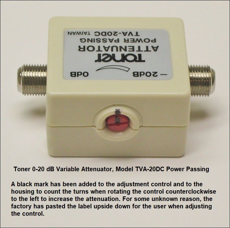

A disadvantage is that there is no way to adjust the gain of the dongle with the Touchstone software, so you need an attenuator to get a good scan.

I didn't use a preamp for this scan. The channel 16 signal (first strong signal on the left) measured -6.3 dBmV (-55.1 dBm) with my Sadelco DisplayMax 800 signal level meter:
Touchstone RF Spectrum Analyzer 2020-10-27 14-45-43.mp4
https://www.dropbox.com/s/no068tnzs...pectrum Analyzer 2020-10-27 14-45-43.mp4?dl=1
When I used a 17 dB preamp (CM7777HD Amplify, low gain setting), more attenuation before the dongle was needed.
Touchstone RF Spectrum Analyzer 2020-10-27 14-27-48.mp4
https://www.dropbox.com/s/18g3b36dm...pectrum Analyzer 2020-10-27 14-27-48.mp4?dl=1
