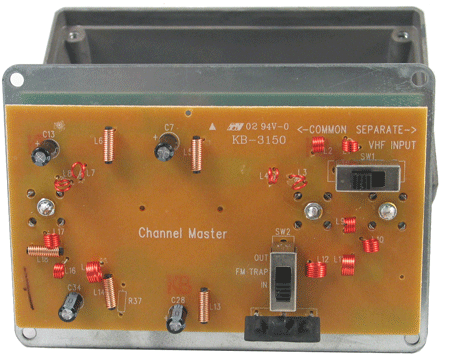

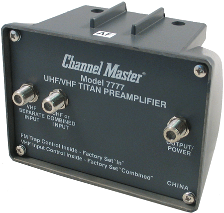

connect antenna to combined input of the cm7777, internal switch is set to common, and fm trap set to out if you desire to receive fm on your receiver.
