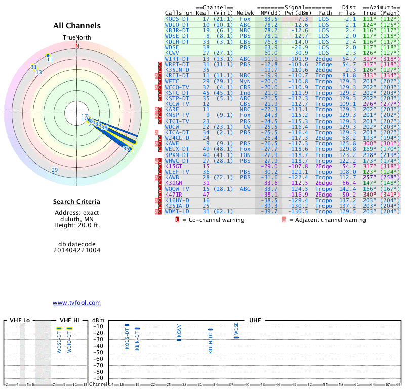

I'll stick with my HBU22...works much better than any indoor antenna :)
That's a nice one. Reasonably priced. And, good VHF.
I use an Antennas Direct DB4, which gets great UHF and surprisingly good high VHF. And, I will be adding a Winegard HD-6010 for FM, as soon as I get off my ass and up on the ladder, which should help VHF even further. (My local NBC broadcasts on RF12, which isn't too bad. But, ABC broadcasts on RF 7.)
agreed. When I was in Minneapolis in the apartment I had it in the walk in closet and it worked fine (Minneapolis stations were 29 miles away)
couple pics
http://www.satelliteguys.us/threads...th-good-VHF-Hi-coverage?p=3314889#post3314889
then upgraded to a 8 bay and a separate VHF antenna
http://www.satelliteguys.us/threads...th-good-VHF-Hi-coverage?p=3417756#post3417756
But now I'm in Duluth so the HBU22 works fine for the 6 stations here.
