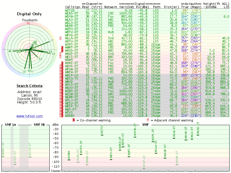

I've included the TVFool.com channel location chart. The two channels I've seen this occur on with some regularity are channels 6 and 10 (Digital channels 59 and 57, respectively). Regardless of their almost 90 degree separation, they both come in consistently in the mid to high-90% signal strength, with my antenna pointed to the south. Channel 10 broadcasts one sub-channel, channels 6 broadcasts none.
