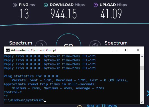

On Ookla, speed test results to Charter's own server located 150 miles away gives me ping results of 13 - 20 ms. Pings to Google return at around 27 ms. At work on enterprise grade DIA fiber from Charter I get 5 - 6 ms latency to the same speed test server and a solid 20 ms to Google. These numbers are not directly connected. At home I get around 22 ms to Google when the cable modem is directly connected to the computer. It's been a long time since I bypassed our firewall at work to see what the latency is plugged directly into the fiber media converter.
High latency is what causes a 3 Mb DSL connection to feel faster than a 25 Mb satellite connection.
Below is my ping summary to Google for 30 continuous minutes. On fiber, your results should be better then mine.

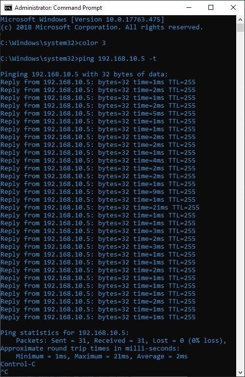

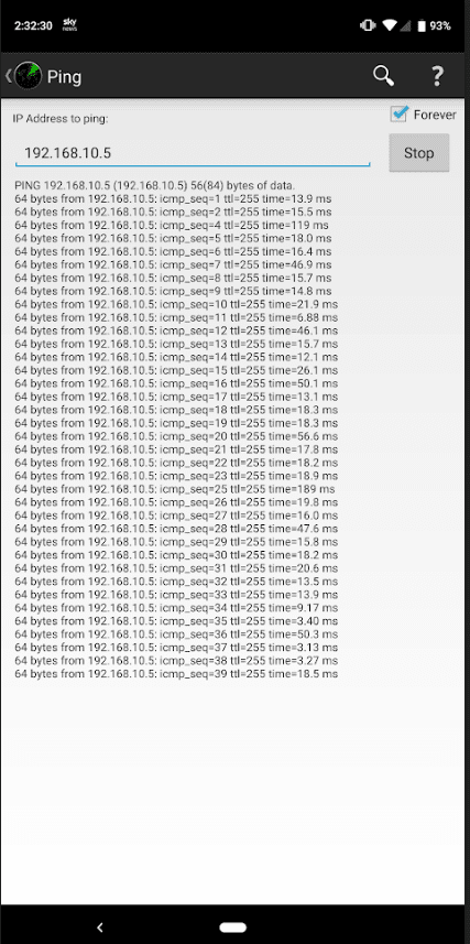

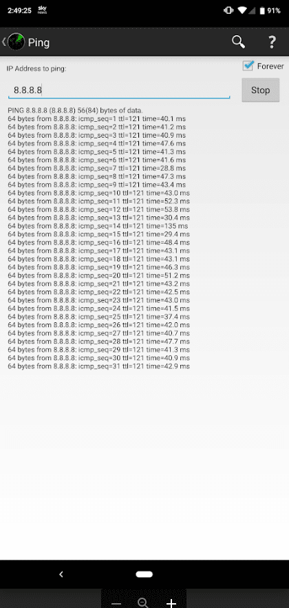

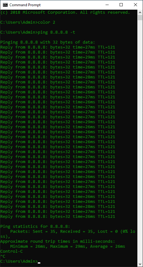

The first step is to figure out if this is a WAN or WLAN problem. Finding or borrowing a PC with a gigabit NIC and connecting it directly to the router via CAT5e/6/6A with be the most ideal solution. If the user experience improves then it's a WLAN problem, if it doesn't then it's a WAN problem. Can you run a ping 10-15 minute continuous ping from the iToys to a device on your WLAN such as a printer that's connected wirelessly or a smart TV or gaming console that's connected wirelessly or even the router itself and post the results?
Attached are four screenshots.
1) WLAN to WAN - Phone on wifi standing 15 feet from the AP in the same room to Google
2) LAN to WAN - Desktop PC connected via CAT6 to Google
3) WLAN to WLAN - Phone on wifi to HP LaserJet MFP on wifi
4) LAN to WLAN - Desktop PC connected via CAT6 to MFP on wifi
As you can see the hardwired pings are much more stable and consistent. If you just showed me screenshot #1 with no context, I'd be on the phone with Charter ASAP, those fluctuations are unacceptable along with hitting over 100ms. I kept the ping going after I took the screen shot and shortly after had three more over 100ms, highest being 168.
