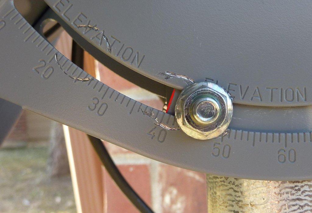

I'm wondering what you used for reference. When I first set my dish I was using the bolt for reference, but then took a closer and noticed what I should have been using. My dish is set for 40 deg using the bit of metal highlighted in red. (like the manufacture should have)

BINGO! I was using the bolt, instead of the edge. It's funny that the skew is marked in red, but not the edge for elevation.
Nevertheless, the elevation still came out to 53 degrees, instead of 49. I checked the pole again, and it is within 1/2 degree of vertical with the dish on it.
