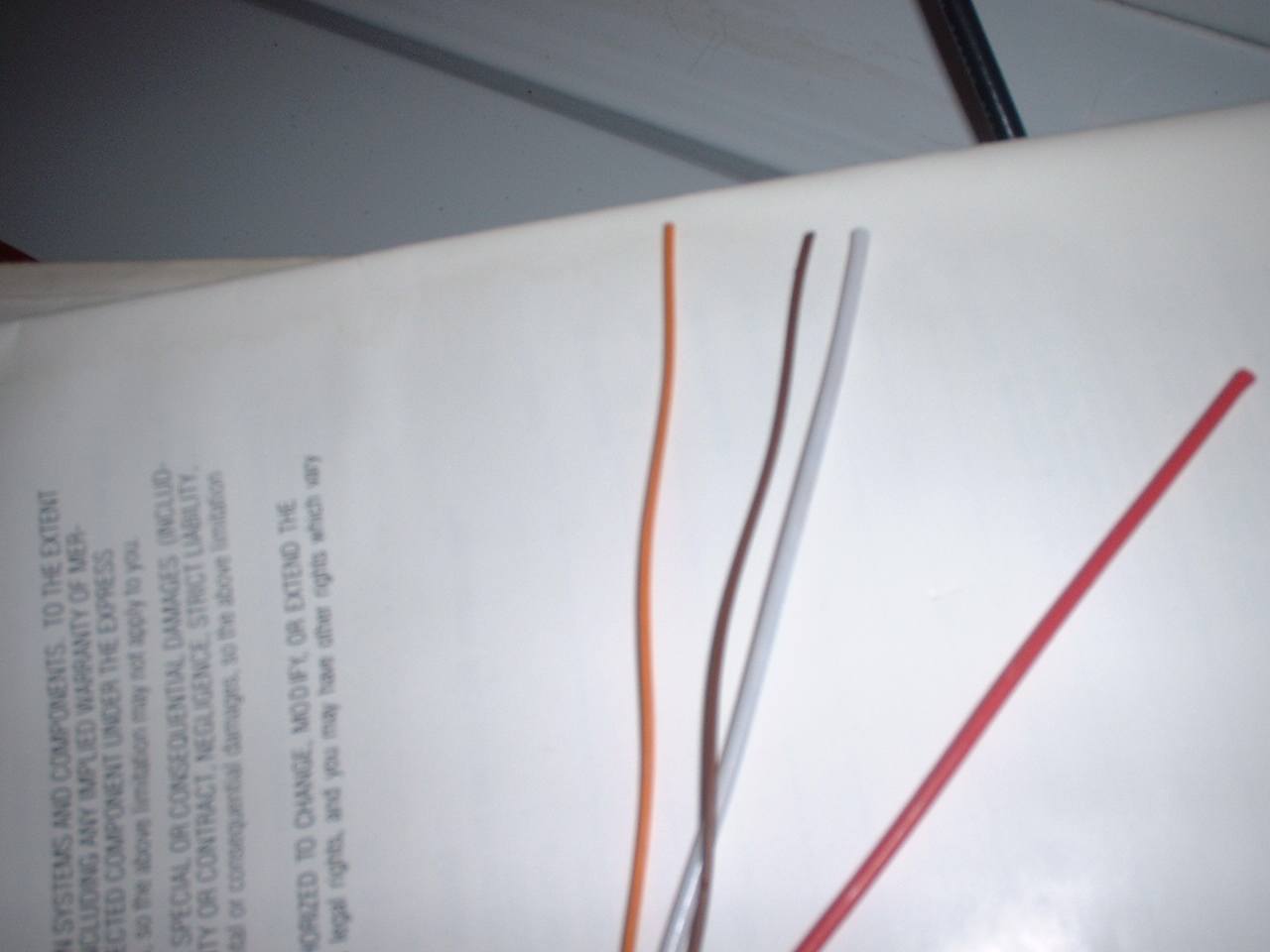

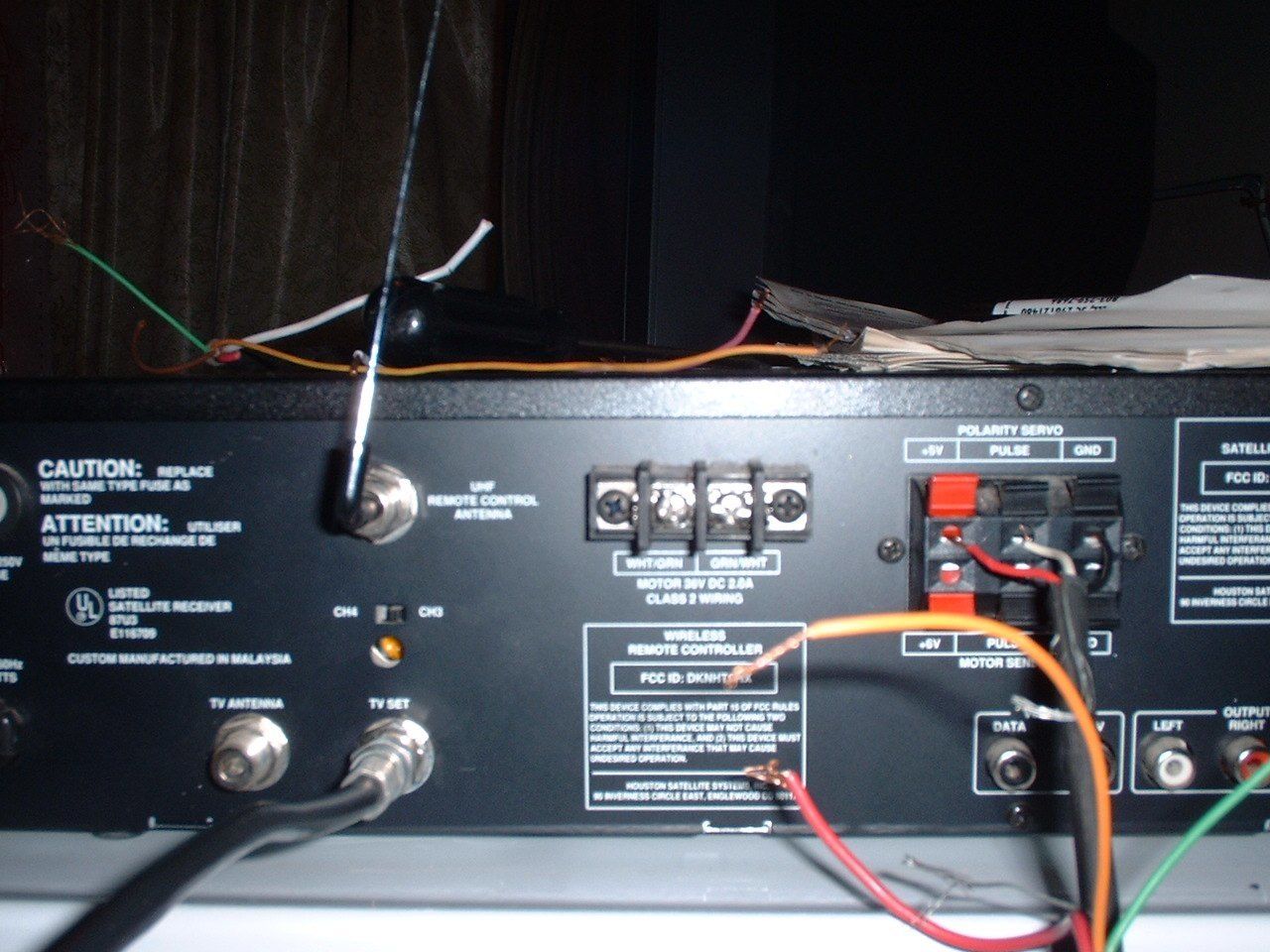

I Have Everything In Place Same Channel Same SAT. but i cant get the Actuator to move. it has 4 wires. those are Red, White, Yellow, Brown...the Actuator is made by GOLD PLUS ....and its a tracker 50 sat receiverbox anyone know how to hook it up. thanks alot for all your support :)
The two bigger guage wires are red and white. These are the actual mover DC power supply wires to the motor. M1 and M2 is what they are probably called on the reciever. Under the motor cover on the arm, just look where the other heavy guage wires connect to. Do not connect the smaller wires to these two power wires as this will damage the reed sensor. After that, I would connect the little wires to their matching wires already under the terminals that go to the reed switch. i have black connected to ground on reciever (i am wild guessing but maybe your brown) and the other (yellow?) wire other on that symbol, and nothing on the +5. This is for a different type of sensor.
Look on the back of the receiver where the actuator wires hookup, note the colors of the wires and be sure and hookup to the motor / sensor or switch exactly the same...(pulse, ground, shield etc...)
can you guys go in the chat room so i can explain this. its hard to explain just by typing here and there.or any instant messengers?

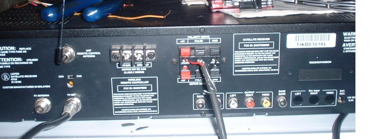

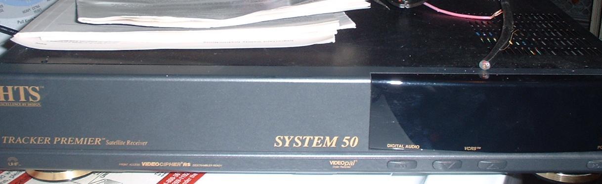

here is the back of the receiver. its a HTS tracker 50

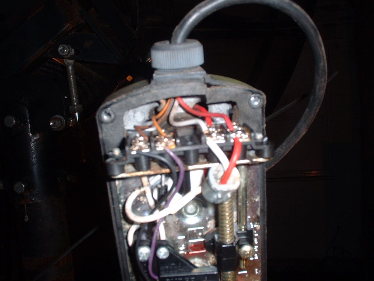

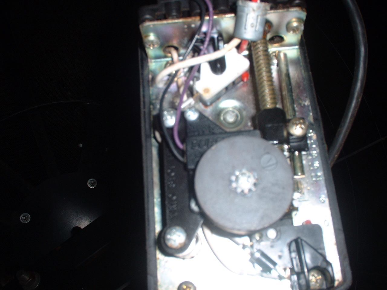

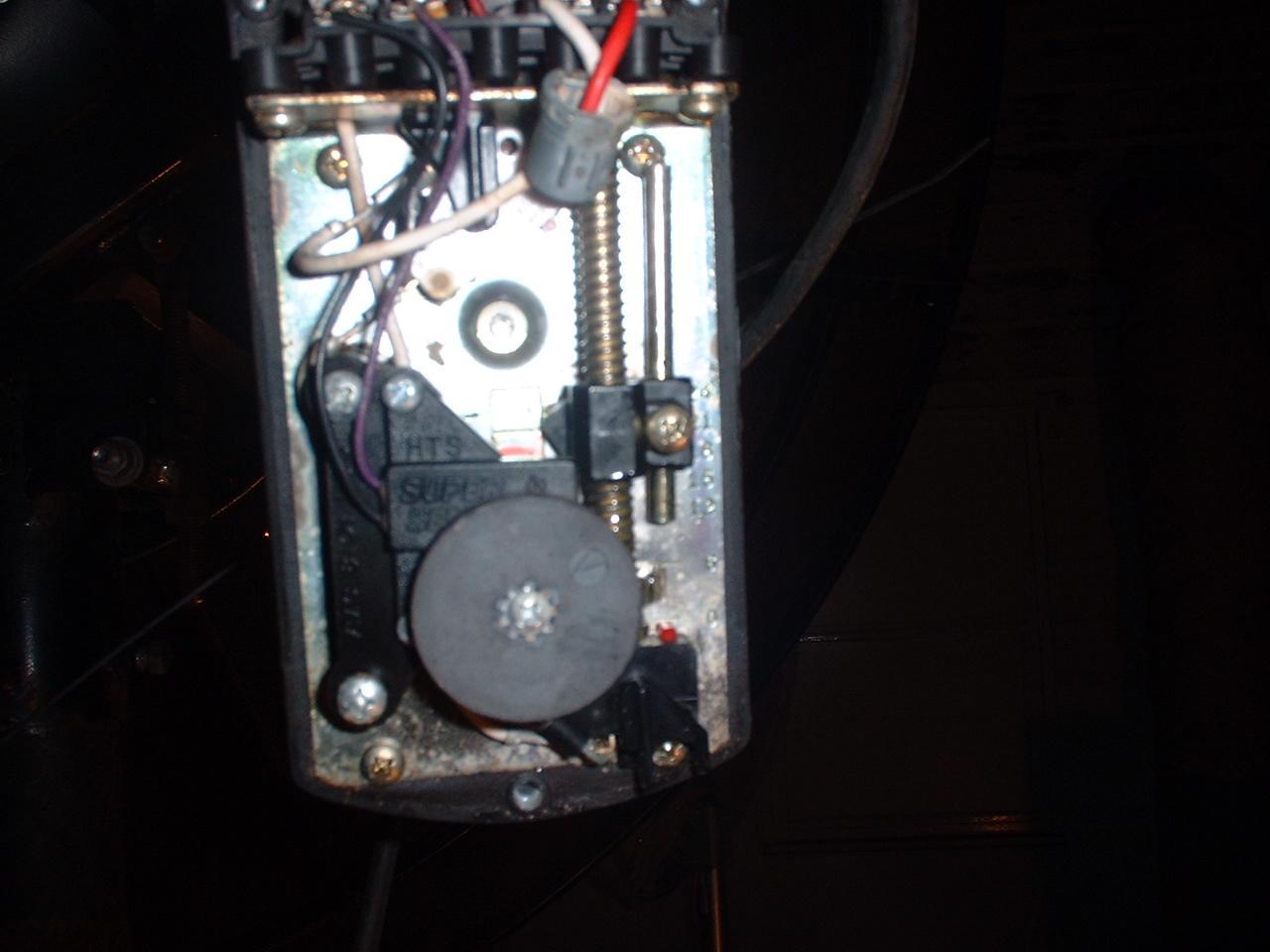

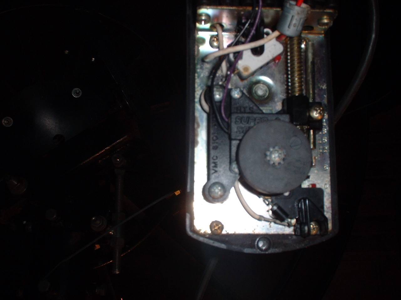

here is the motor

I Figured Out Why The Reciever Was Saying Motor Error The Actuator Was Frozen Up I Greased It Up Real Good And Started Turning the Bottom Of It By Hand And it loosened It And Letting It Sit Overnight. If Not Maybe The Motor Is Great It's just the arm it self it was rusted badly inside anyone know where i can get one? 24" or 18" arm "ill be in chat if somone has one"
FWIW, since the sensor wire in most ribbon cables has three, 22 or 24 gauge conductors, and a shield/drain wire, but since nearly all jacks sensors only need two wires, most installers twist the green and drain together to form one larger gauge wire, and the other two wires (brown, yellow or orange) to form the other.
