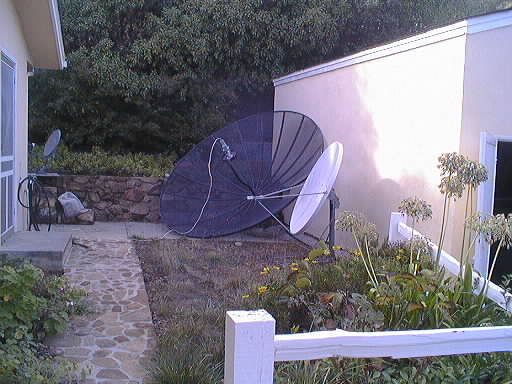

Don't need no stinking pole. It's a 10 footer. Only need one bird.
