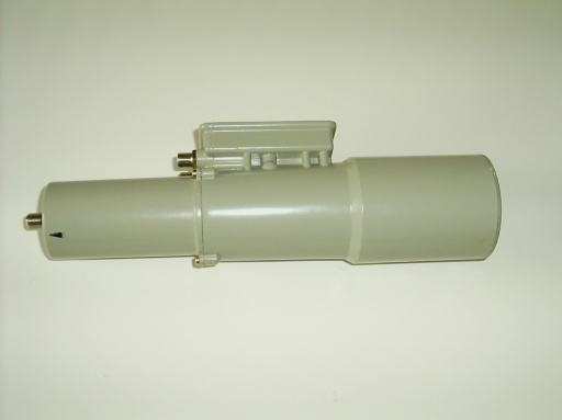

By bsc621 doesn't have lines on it....but it's worth a try I guess. Is it possible I'm not inputting the right VPID & APID's. I'm getting them off Lyngsat? Like I said before, when I input VPID & APID for Wings for example, I use VPID:52 APID:51 then scan and get a channel: Ch-A but just a black screen with a signal of 50???? I'm stumped!
can you manually scan the transponder (not a blind scan, just a TP scan)
even though the signal quality says 50, if there isnt enough quality to keep a stable picture, it wont even scan in
The BSC621-2 does have a skew mark on it, its like a small arrow! (I marked mine with a black pen)
