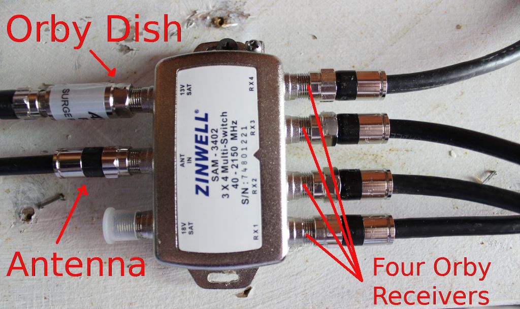

This is my setup that I installed myself. I have a mast-mounted amp for my antenna to boost the OTA signal before distribution. The OTA coax and the Orby coax are fed into a Zinwell SAM-3402 multiswitch which then feeds our four Orby receivers. I also have ASKA PT-1 surge supressors on both coax inputs. Here is a pic of my connections.
I think the surge can cause more problems than it solves.
But that's better than the diplexer and splitter.
I believe they even make a multi switch that amplified the antenna input

Sounds like as an installer you are really kind of ham-stringed by policy and what a company you are installing for is willing to reimburse. Sorry, but IMHO that is not the way to do business (them, not you). I can understand why you no longer do some installs if that is the case. I have always believed that if you do something you do it right or you don't do it at all. Service quality from 'another satellite company' is why I dropped their service years ago in favor of OTA and FTA and is why I do all my own install work. Even with the monthly cost if I wasn't given the opportunity to do my own Orby install then I likely would not have tried their service at all. So far I am happy with it. I have had one interaction with a company representative who spoke clear English and handled my problem, reactivating a receiver after I had to reset it after a lock up, in a quick and satisfactory mannner. :)
Yes, that is definitely true. If you are near the transmitters and have strong signals already then amplifying it can mess with tuner. No issue with that here. At 41 and 57 miles away with two edge reception I couldn't get a strong enough signal to use a splitter unless I amped it. ;)

How much distance do you have between the ODU and 3x4, then between the 3x4 and your receivers? Just curious of what kind of attenuation you are seeing with the 3x4.
@FTA4PA
Sorry for the late reply. Our living room tv/monitor's backlight kicked last night so checking Sat Guys was backburnered. :rollingeyes
Coax in from two combined antennas is less than 40 feet. The four runs out to the Orby receivers varies but I'd say shortest is about 25 feet and longest is about 45 feet.
