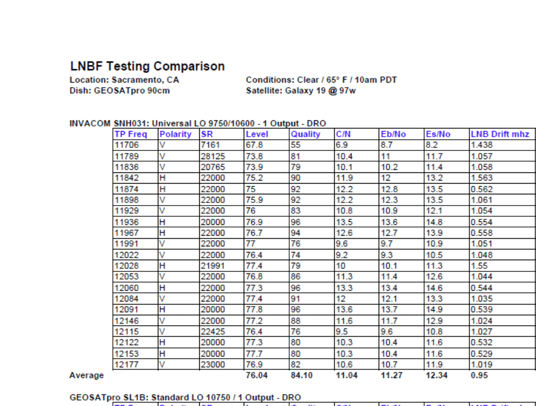

I just received an Invacom SNH-031. Just planning to check it out vs the existing ones I have.
A dumb question maybe, but an LO of 10750 has been a standard of the inputs in setting up a dish to view. This unit says 'LO 9.75-10.6 GHz'. Does that mean it won't work on 10750?
Thanks for an opinion.

I was just reviewing the reason I got this Invacom. The test Brian did demonstrated how good this lnbf is, so I just bought it. Now in review, his info does describe the device as a Universal, not a Standard.
I'm going to try by setting my meter to 10600.. And thinking.. What if I set the LO on the receiver to 10600?

An Universal LNB LO is in two bands of 9750 / 10600
Band 10.7 - 11.7GHz = LO Low 9750 (22KHZ OFF)
Band 11.7 - 12.75GHz = LO High 10600 (22KHz ON)
If you select Universal LNB LO setting the meter / receiver usually automatically switches between the two LO frequencies. If you select LO 10600 then you must turn 22KHz ON
I did as you suggested, Brian. It works. I had to change my 1100c LO and turn 22k on.. The bigger lnbf gives better numbers!
