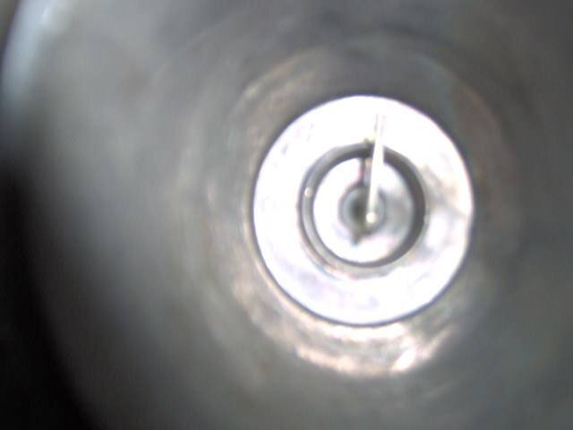

Tim here is the picture down the barrel of the LNB...just the one "notch", stick, etc

Iceberg said:
Stephen
The majority of us use the DSMI 421 C-band LNB. PSB has them
And, 4DTV receivers (at least the 920 and 922) can use voltage to change polarity in case you have one of these types of feedhorns. Seems like some late model GI receivers could do that too...

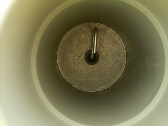

Icebergs picture is a wee bit out of focus, here is another shot of a polarotor .....
