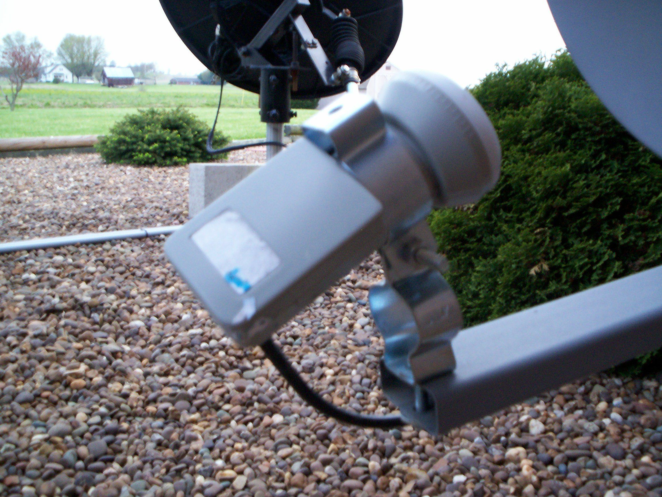

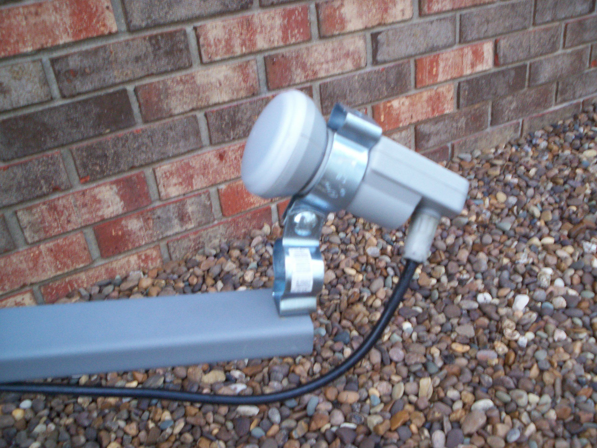

I mounted my linear LNB to the dish with 2 "conduit" hangers bolted together to get the proper aim and position for the lnb. Matched it up to the old DTV lnb to get the proper angle and postion.

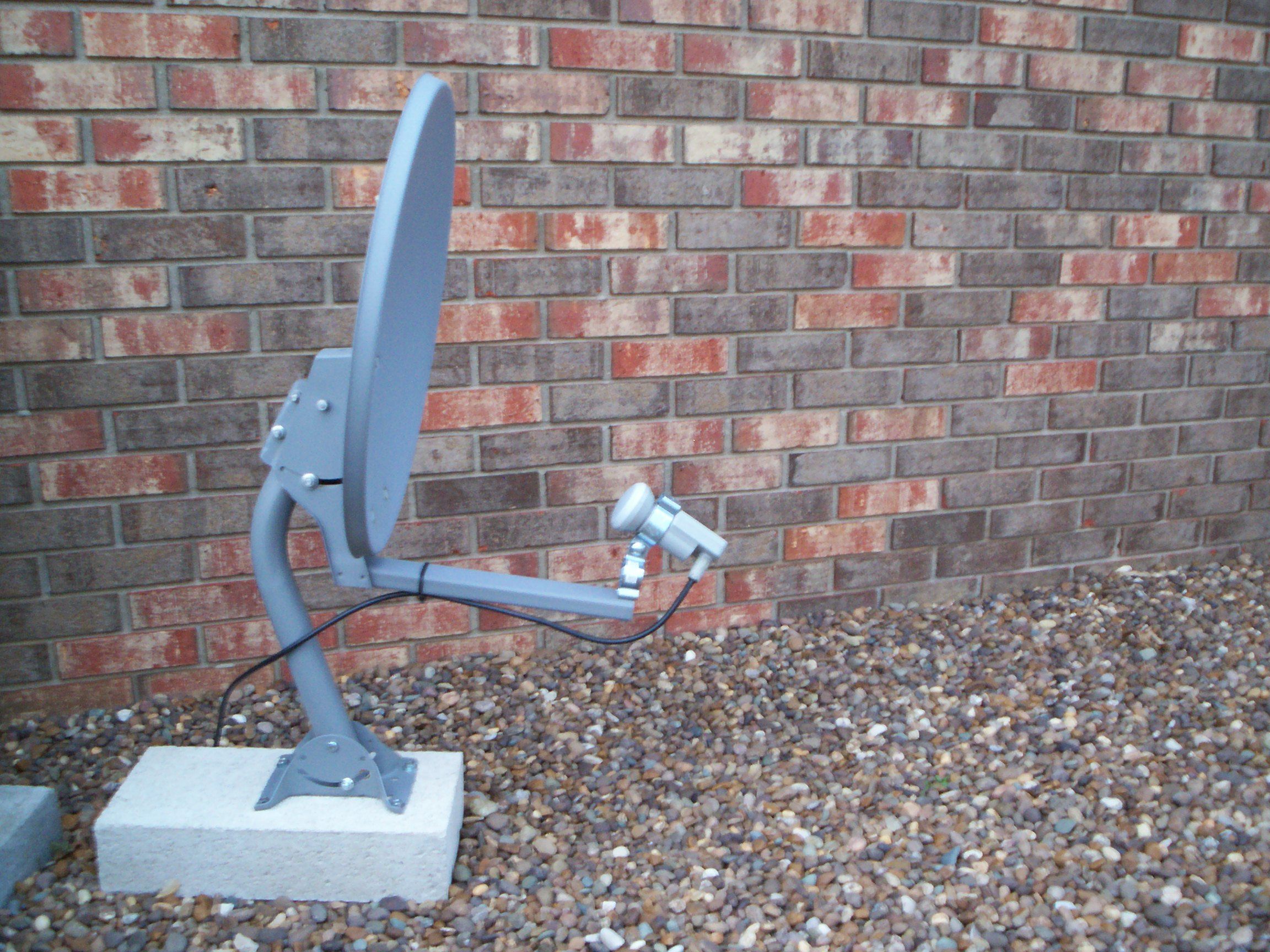

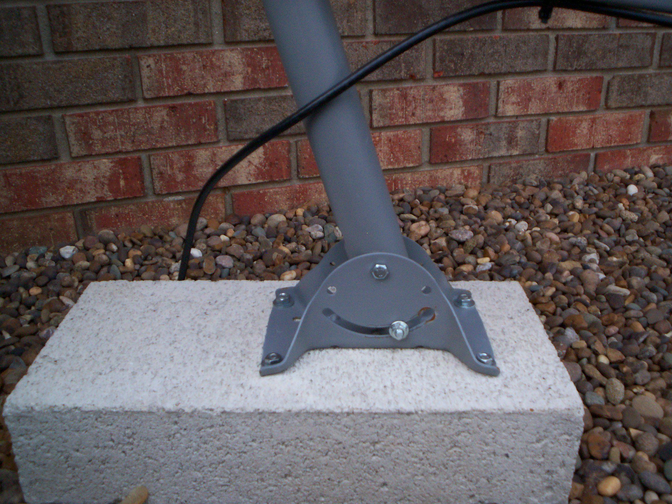

I bolted mine to a concrete block, aimed the block toward the sat, set my elevation and started searching.

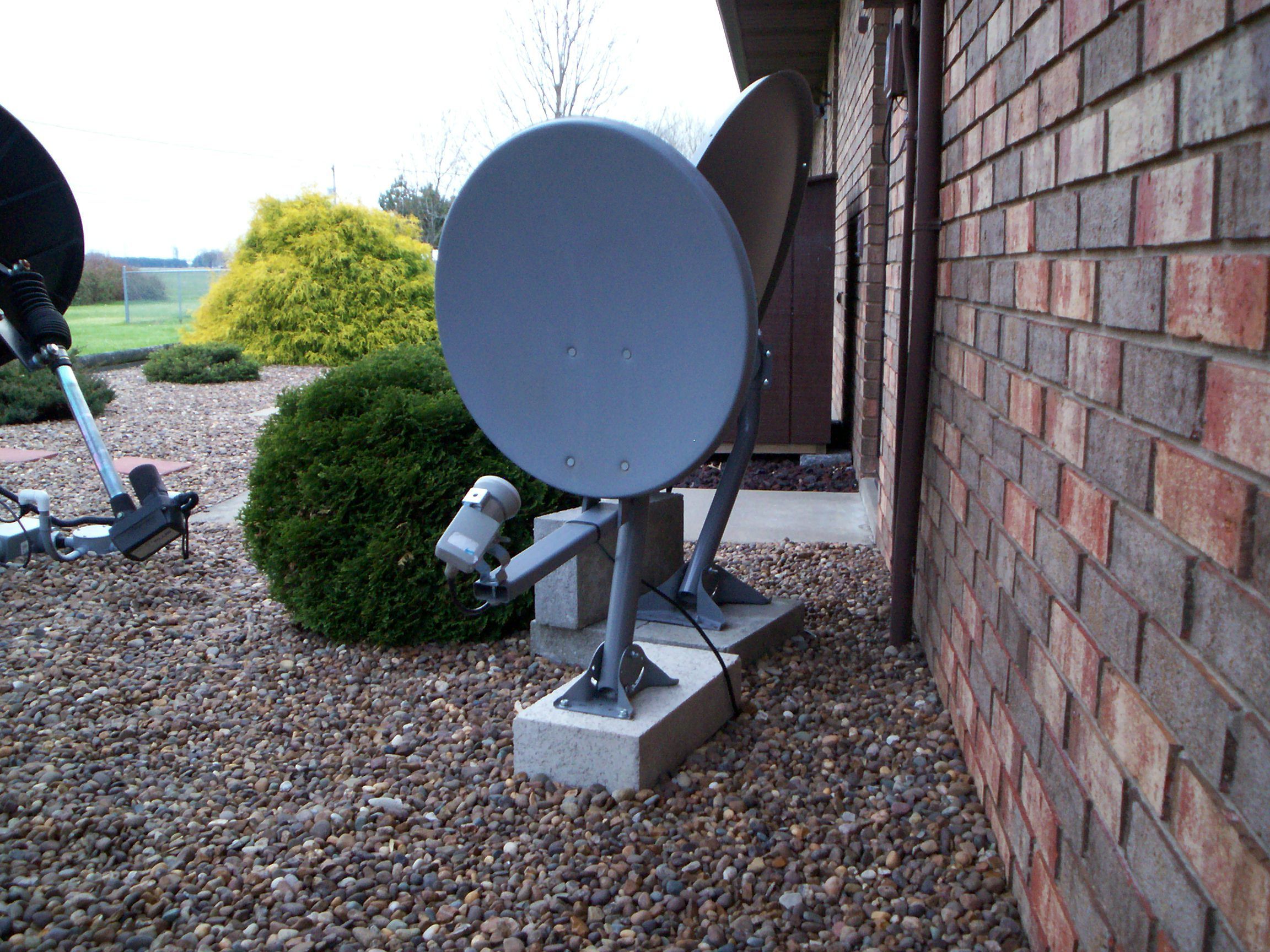

Here's pics of my Hispasat 18" dish.
I'm using an Extreme LNBF and a Pansat 2700a receiver.
Note the LNB skew adjustment.

The hardest part was mounting the LNB in just the right spot. I would like to make a better bracket, but haven't got to it yet.
I had actually had a 76cm aimed at it before to scan in the channels, then hooked up the 18inch to try. So I had a known good signal to look for.
Been using the 18 all winter, works "most" of the time.
