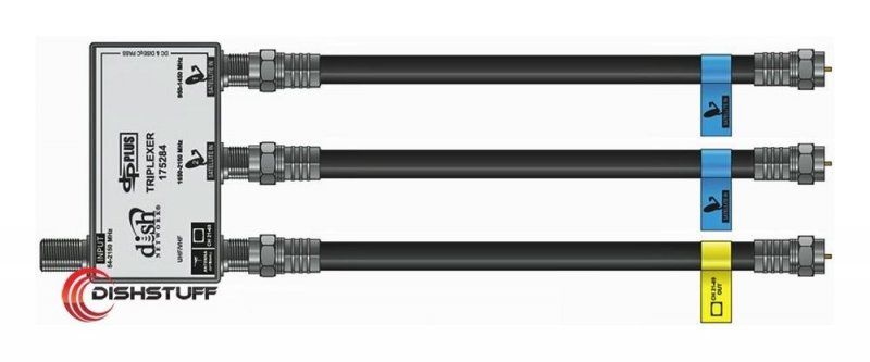

Using the red, white and yellow outputs on one of the receivers is the same as using TV2 output on your old receiver, just that they need to go to an RF Modulator, when feeds cable to the splitters - which is why I said I wonder how your setup was cabled previously. In other words, where did the cable from the TV2 Out (or HVN) start go to connect to a splitter? Did it come straight out of the HVN or yellow port on the receiver?
Or was there a Triplexer connected to the receiver with "splitter" that's actually a diplexer that sent cable to the TV2 splitters?

View attachment 137069 View attachment 137070
triplexer as pictured
