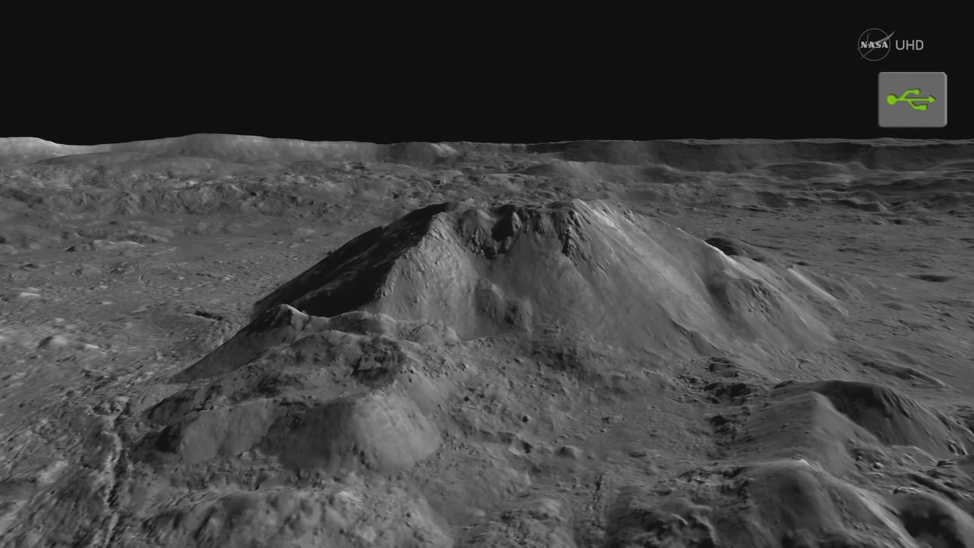

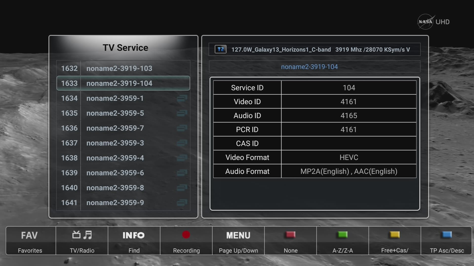

Just a little off topic here, as this thread is about Edision, but also discussing NASA UHD and i just found out i have 1 receiver that still works with NASA UHD to my surprise. Its called a U5 PVR Deluxe, (Android) and i decided to try out NASA UHD today and it works great. I looked at the specs and it said it does 10 bit so i thought what the heck, and tried it. Here is a couple of screenshots taken just now. Mods please move this post if it is too off topic.
