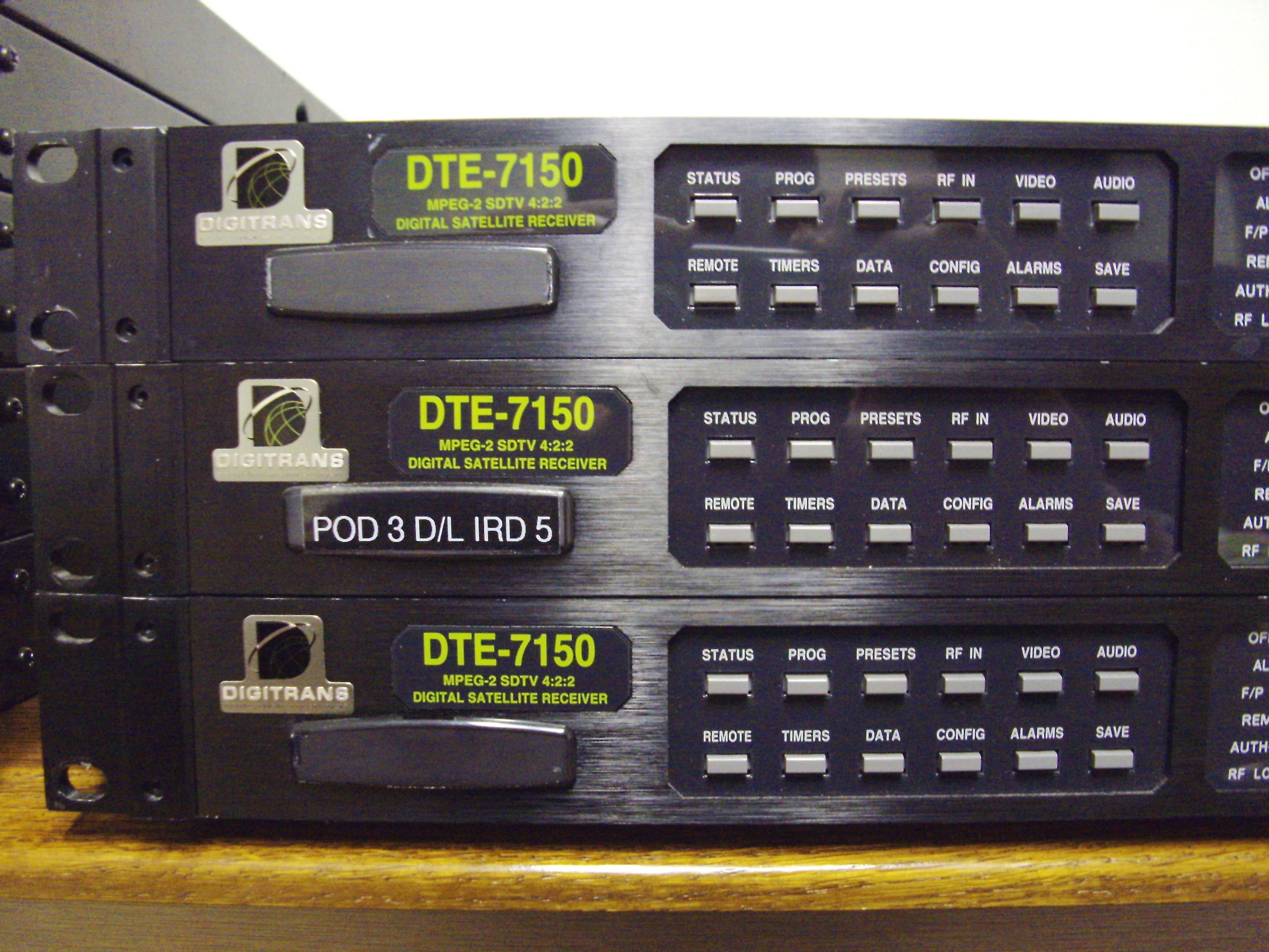

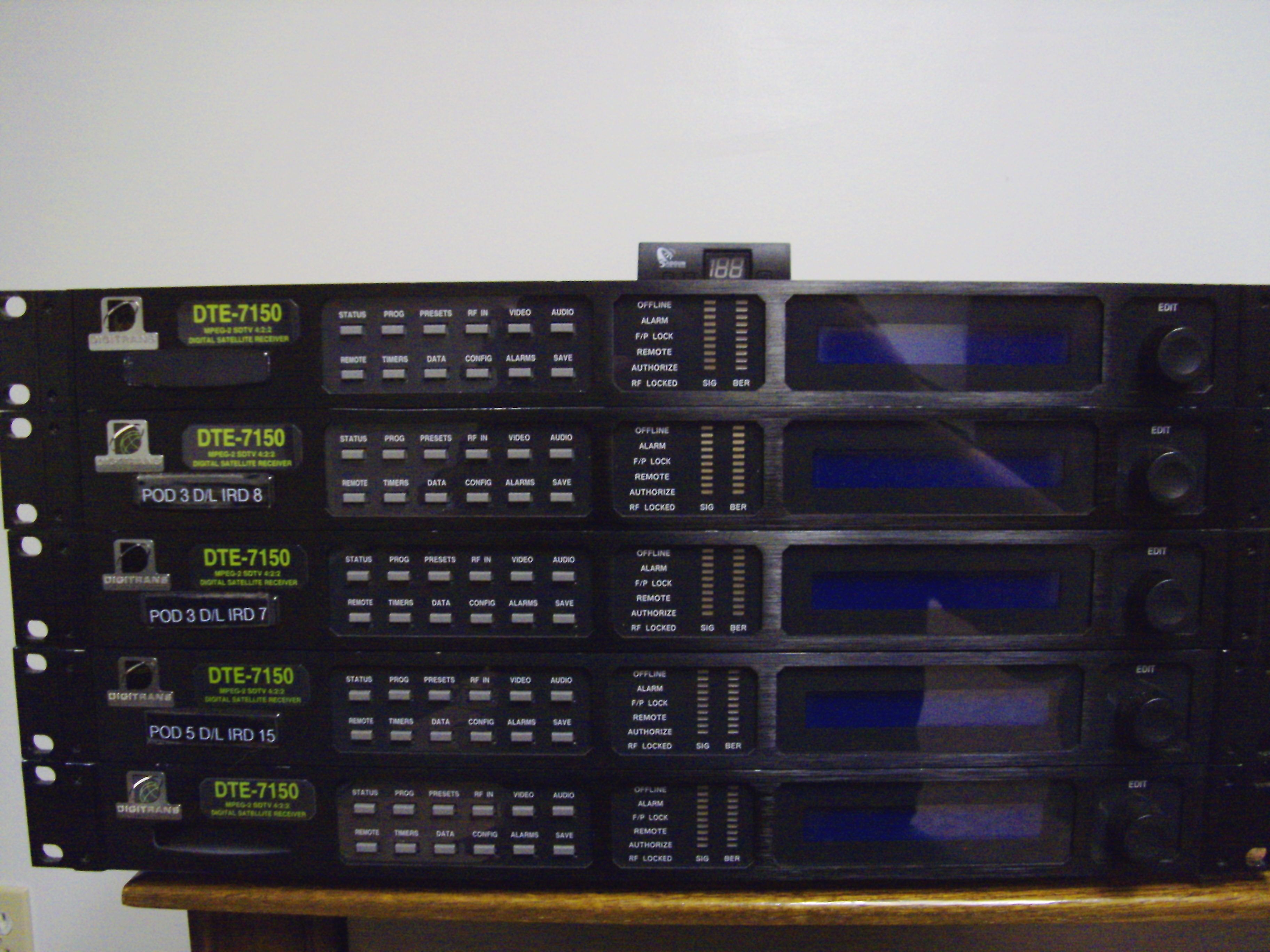

Yeah the 4800 series (also known as the digitrans 7150) will do both DCII & DVB (also will do DVB 4:2:2 too)
Also note if you are looking for one that if the ID reads all 0's the unit is a doorstop :(
It will power up and do everything but wont log any channels in

My dte7150 will show all zero's for the ACE ID number until it gets a DC2 Signal than it shows the same number that is printed on the bottom sticker.. Just send those 7 door stops my way!!!! LOL!
When a consumer DC shows all zero's or has a RID that don't start with 000-021 or 000-031 its usually toast. The commercial units have a battery also and keep info in ram in the XC chip too. So battery replacement is not only for our consumer IRD's. I wonder if Motorola will reload a XC chip if the unit is commercial. They spit on us.
Those 2 are dead. I tried them on Shaw Direct and it wont work. No signal...one finally showed a signal but no picture and no maps. It shows all zeroes for the RID (ACE).
Sounds like a classic case of ROM flushed in XC chip to me. Take it apart and measure voltage on the battery. Weird thing is in the 4DTV they will load a bogus RID & UID after battery replacement on brain flushed IRD and will keep that # with a new battery. The XC chip is designed to spit out a number the first time it's powered up. Thats how the factory loads them from what I understand.
