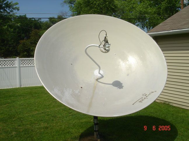

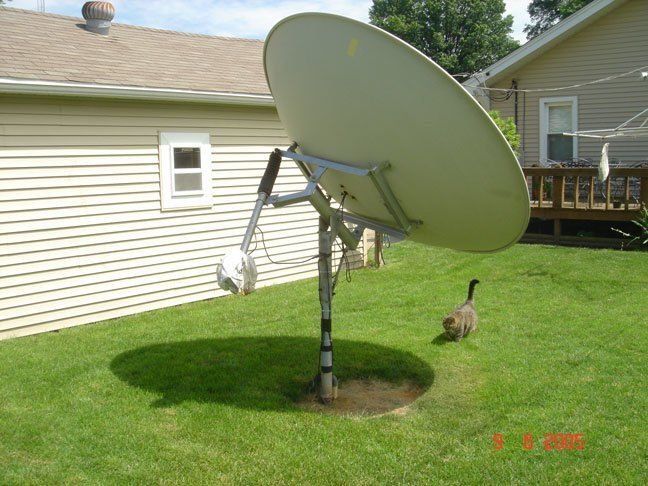

Farmerchief,
This is my set up, I have a Satwork 3618 slaved through a Motorola 922 and I get C/Ku analog and digital and FTA C/Ku DVB. You can't beat it.
