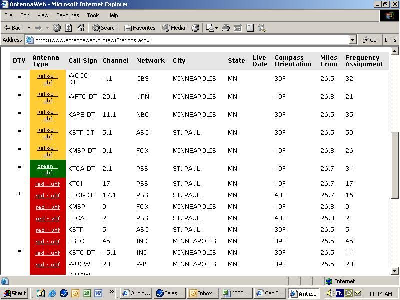

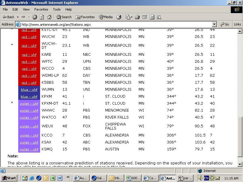

Here is what antennaweb said. Disregard everything in purple because its wrong. The only station in that batch I could get is 41. The rest they're smoking something. The rest are too far away and the only way to get those is to put a 200 foot mast up :)

In the antennaweb report, ignore the "channel numbers" - what you are interested in is the column on the far right, frequency assignment. This is actually what channel you will need to receive to get the digital.
