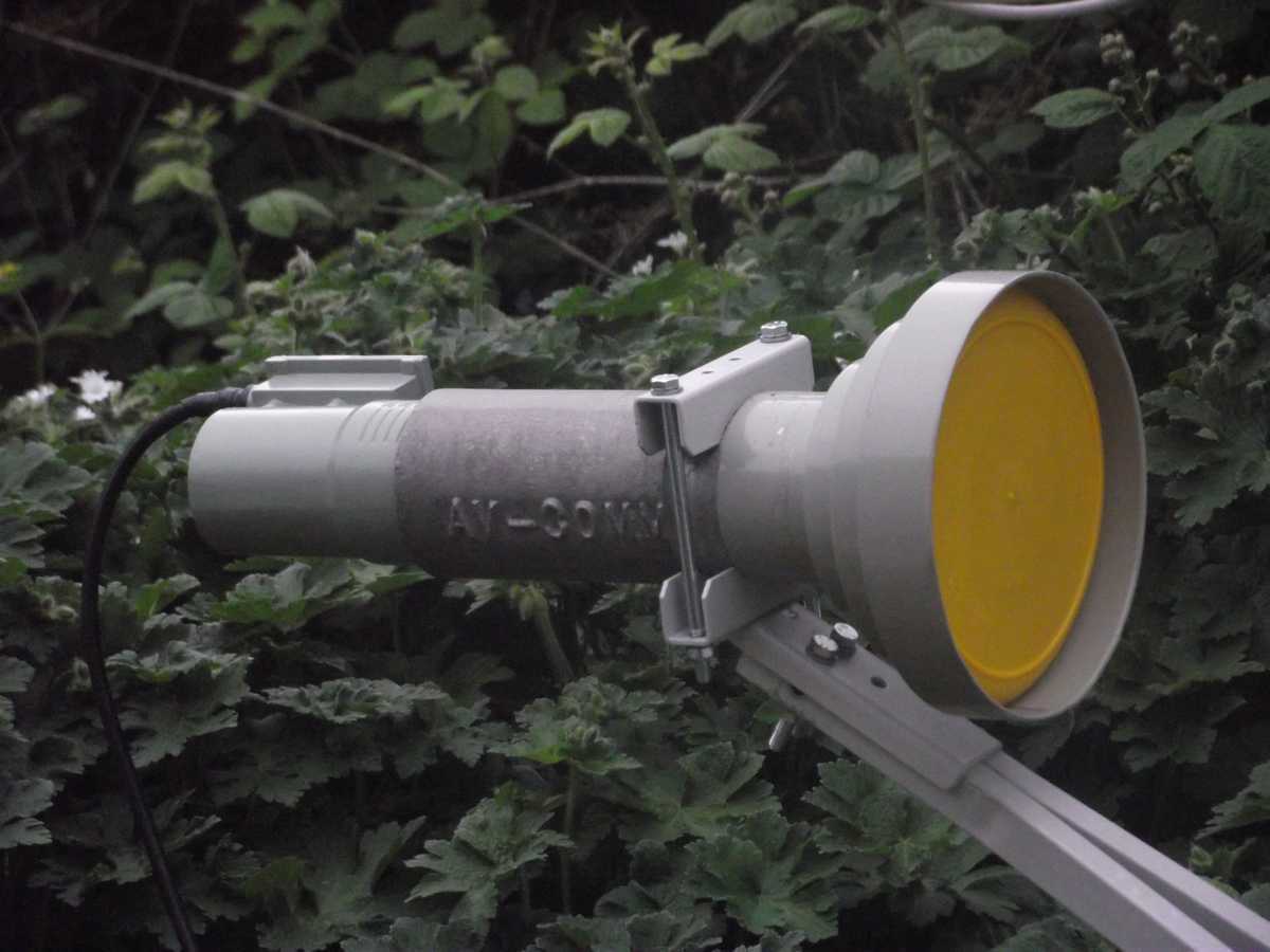

I came to the conclusion after reading German forums about the polariser that it had not been setup in correctly, now seems to be okay also my dad as I've said is better at metal work has fashioned a better simple way to attach the full C band LNB to the LNB arm and now it's increased signal across the board, some by 10%. I've come to the conclusion any home made LNB C-Band collar won't work well so ordered one designed to go with a Gibertini dish from Germany we'll see how it goes..
Gibertini Collar arrived and works well and looks so much better, my dad came up with idea to cut down a plastic plate from an old picnic set and just pop it inside, seems to be no signal loss with it fitted hopefully it'll keep the water out.

Lookin good. (Envious as to how well it's working for you)
I 'kinda' did the same with a Ku feed. Soda bottle and heat gun to for a weather-bug shield. Doesn't look as neat as your's but does the job.
As long as it works mate :)
