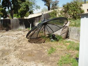

Hi All,
I was looking on a website and someone is giving away a free c-band big dish. I'll post the pic below but I had a question. Will this dish work for both c/ku receiver? Not sure how big it is... looks like a 10'-12' dish but can't really tell.
I was planning on picking this bad boy up but I wonder if its any good :o

Look to see if you can pass a pencil through the mesh, if not then it is goodfor Ku-band, make sure it is atleast 8.5' if so grab it, you don't want a dish under 8.5' they are poor at C-band.
You can also look around and see if you can get a dish with all the parts.
