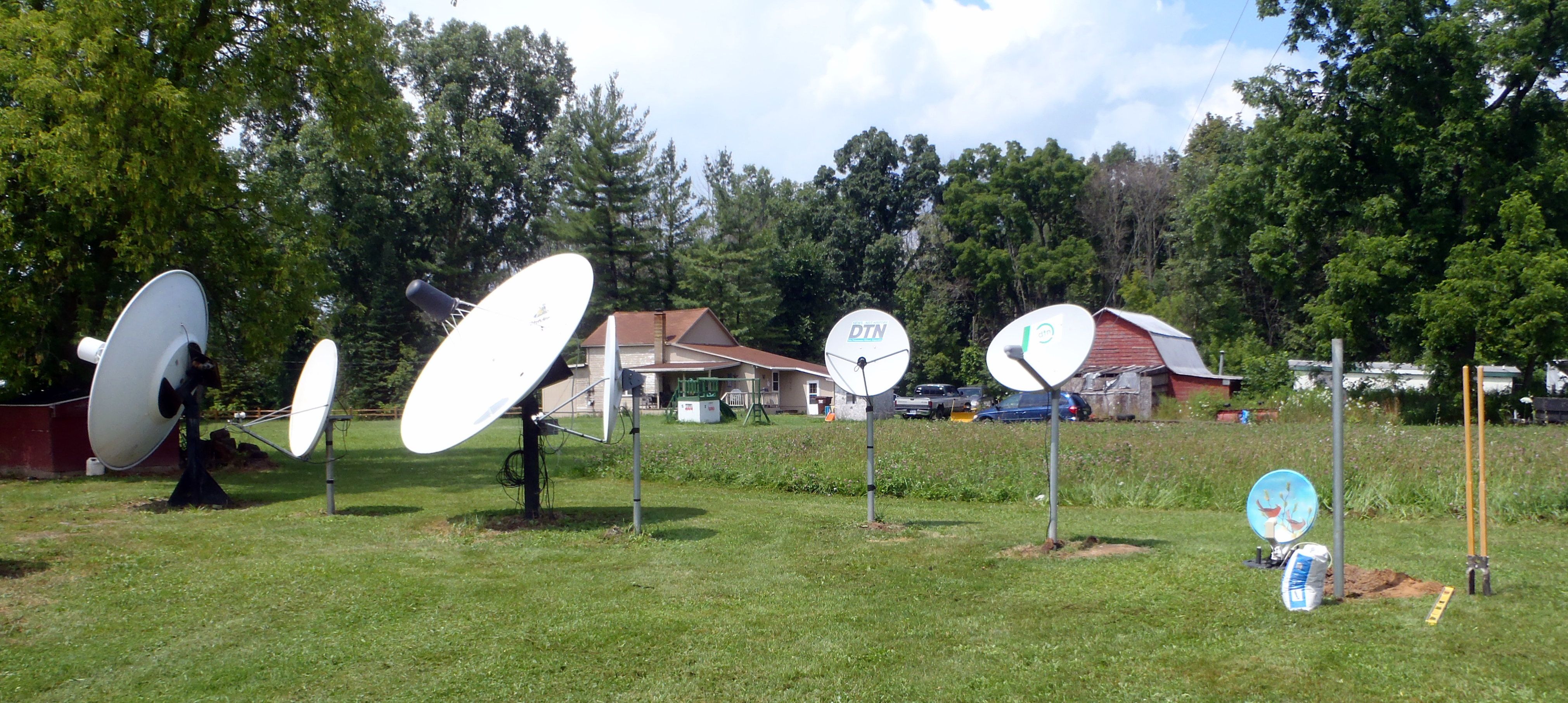

Welcome to the BV club! The tripod mounts were somewhat rare, and early. Many were used by dealers for demos on trailers. I was lucky enough to get one, but if you use that, make sure there's plenty of concrete BELOW. As a rule, the regular consumer poles had fins at the bottom to keep the large pole from rotating in the ground, the lockdown keeps the top level and secure. You are correct, these are NOT the original supports. If the "nubs" are still on the dish itself, you can get some aluminum stock, thread the ends and use the original "hexopod" mount. Should you want an original Scalar to play with, I may have a few left around here, and my modification was to have a friend with a lathe mill-out the center hole a little larger to accomodate today's LNB's. I have one BV dish as a c/ku motorized, and one aimed at 137 West for Alaskan TV right now as part of a 7-dish setup. You'll love owning one! The fact that it is not the original feed puts it at the later 1980's when Birdview got a bit smarter, abandoned their proprietary dual-LNB feed for multiple rooms (their receiver's frequencies were not the same as standard receivers and the "new" IRD's of the day) and they started offering upgrade kits of reed kits and "high block" LNB's....The other explanation for your odd supports is that somehow the original mount was damaged, and more 'standard' parts were used for the retrofit.

today's dish farm picture with more additions attached........(we've finished adding the 7th dish, of course.)
If I can lend any ideas or info, don't hesitate to ask. I no longer subscribe to any services on C-band, but use my setup exclusively for FTA!
