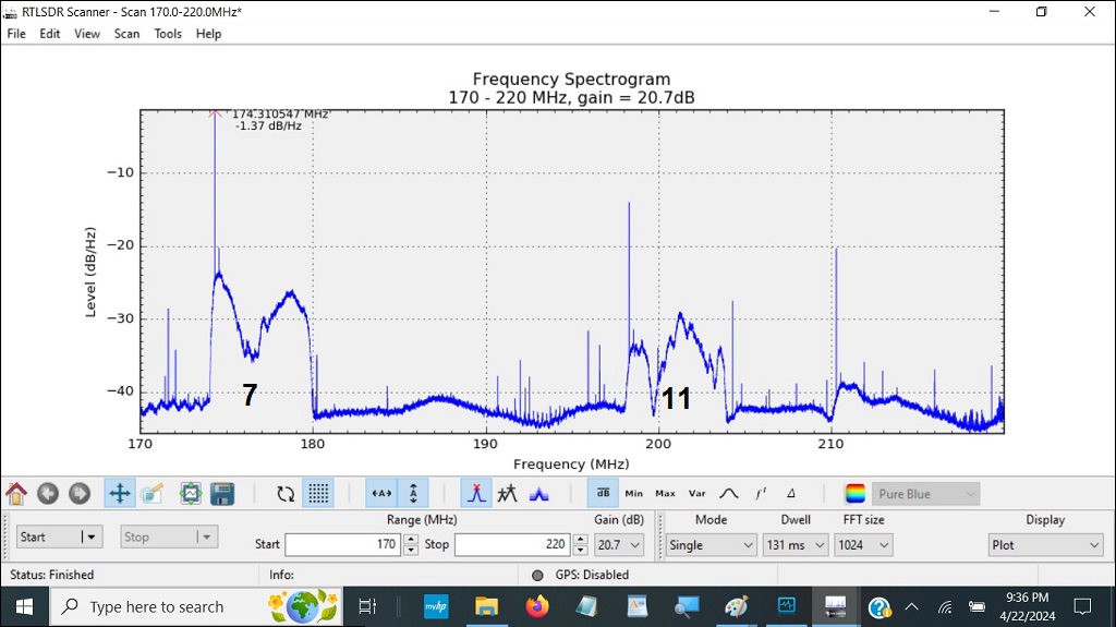

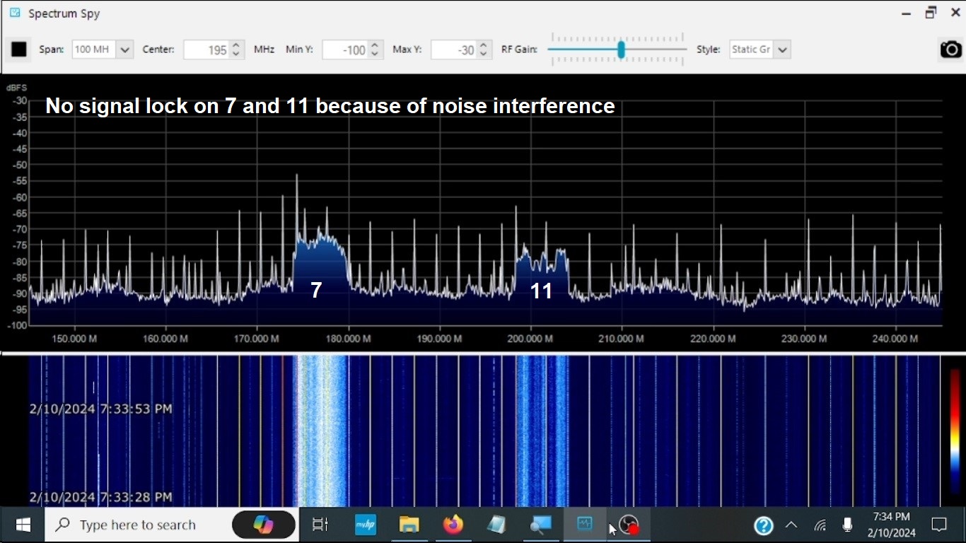

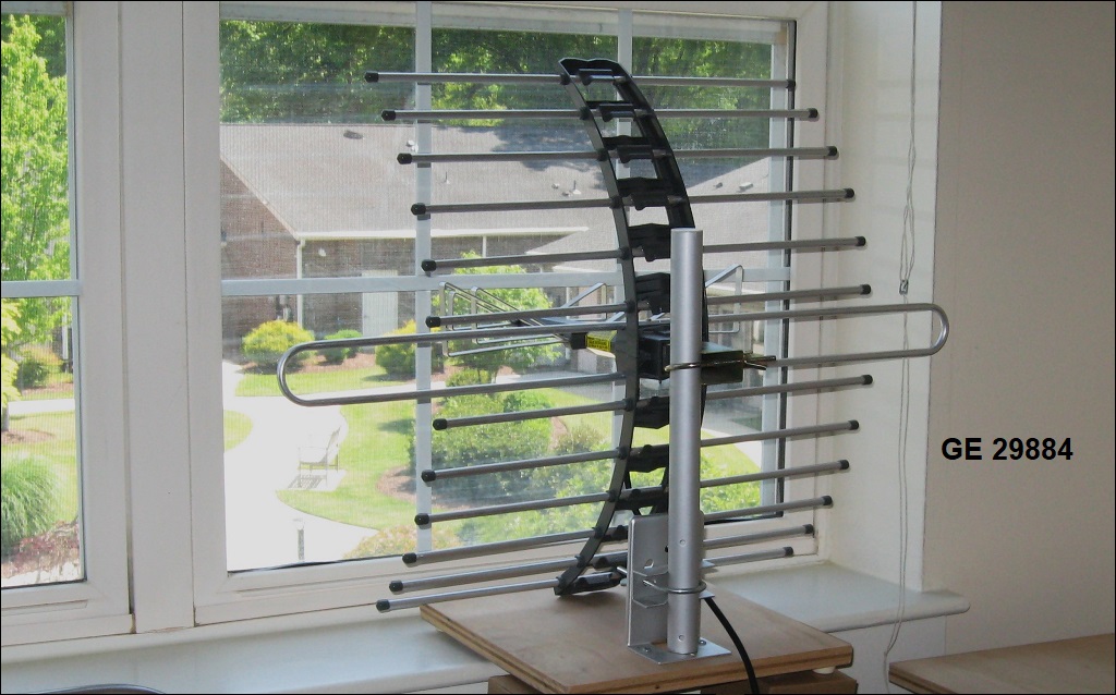

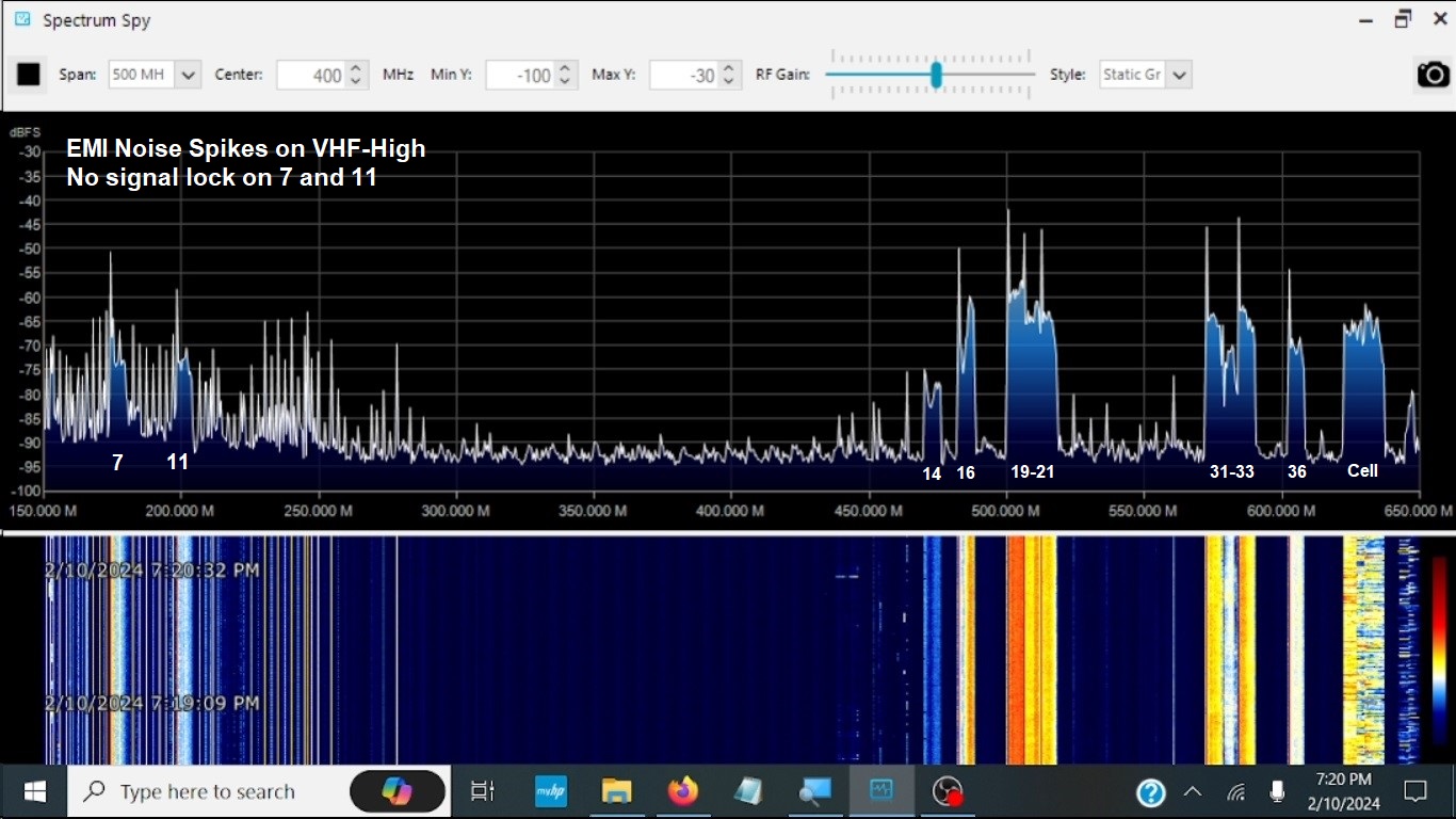

I have a very high noise level from electrical interference to my indoor antenna that makes it difficult to receive VHF-High channels 7 and 11.

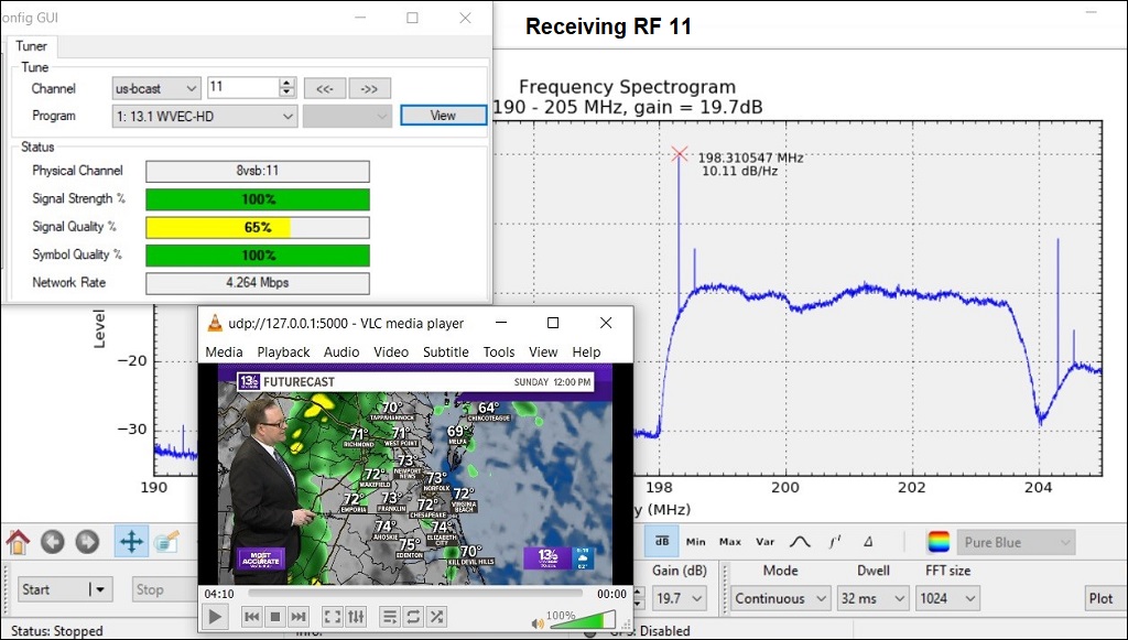

The tools that I have been using are an RTL-SDR V3 SDR ($30) with RTL-SDR Scanner software and a SiliconDust HDHR4-2US tuner. The SDR shows me the shape of the signal and the HDHR GUI gives me the signal quality. I find it awkward to use BER in scientific notation and much prefer to use other metrics of signal quality including SNR and MER.
Those measurement tools allow me to try different antennas, different antenna locations, and a preamp to find the best combination.
