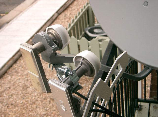

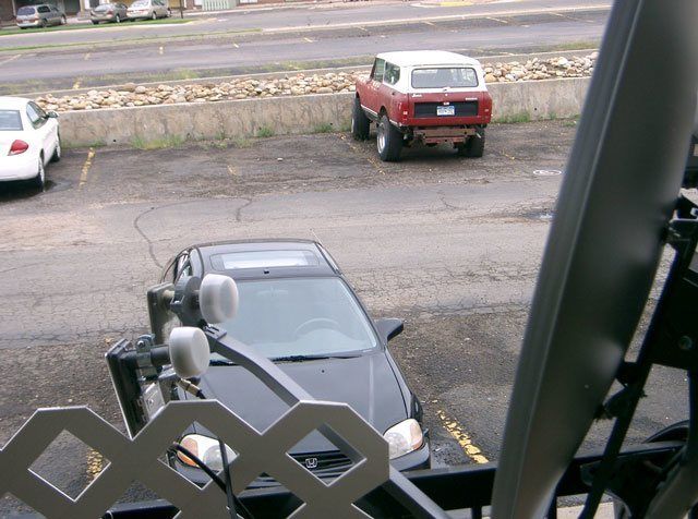

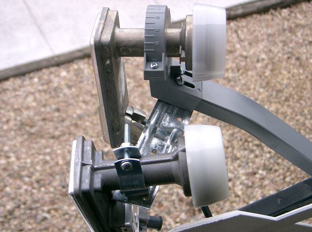

I had to bend and flatten the L bracket I found at Home Depot for my needs. There's probably something better out there but i didn't want to waste too much time.
I bent the L bracket with pliers to point the LNB up/down. Where the conduit hanger attached to the L bracket, I could adjust the left/right aiming by just pivoting it back and forth. The L bracket was mounted to one of the screws that holds the main LNB mount to the arm. It was mounted at an angle (not straight across). Here's what I could take before the sun went down...
Thanks! It was easier than I thought it would be. I couldn't have done it without the posts here and my cheap signal meter though.
