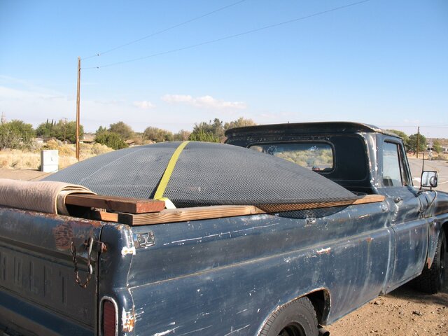

I used bolts through long boards to hold the dish.
Then the boards were strapped down.

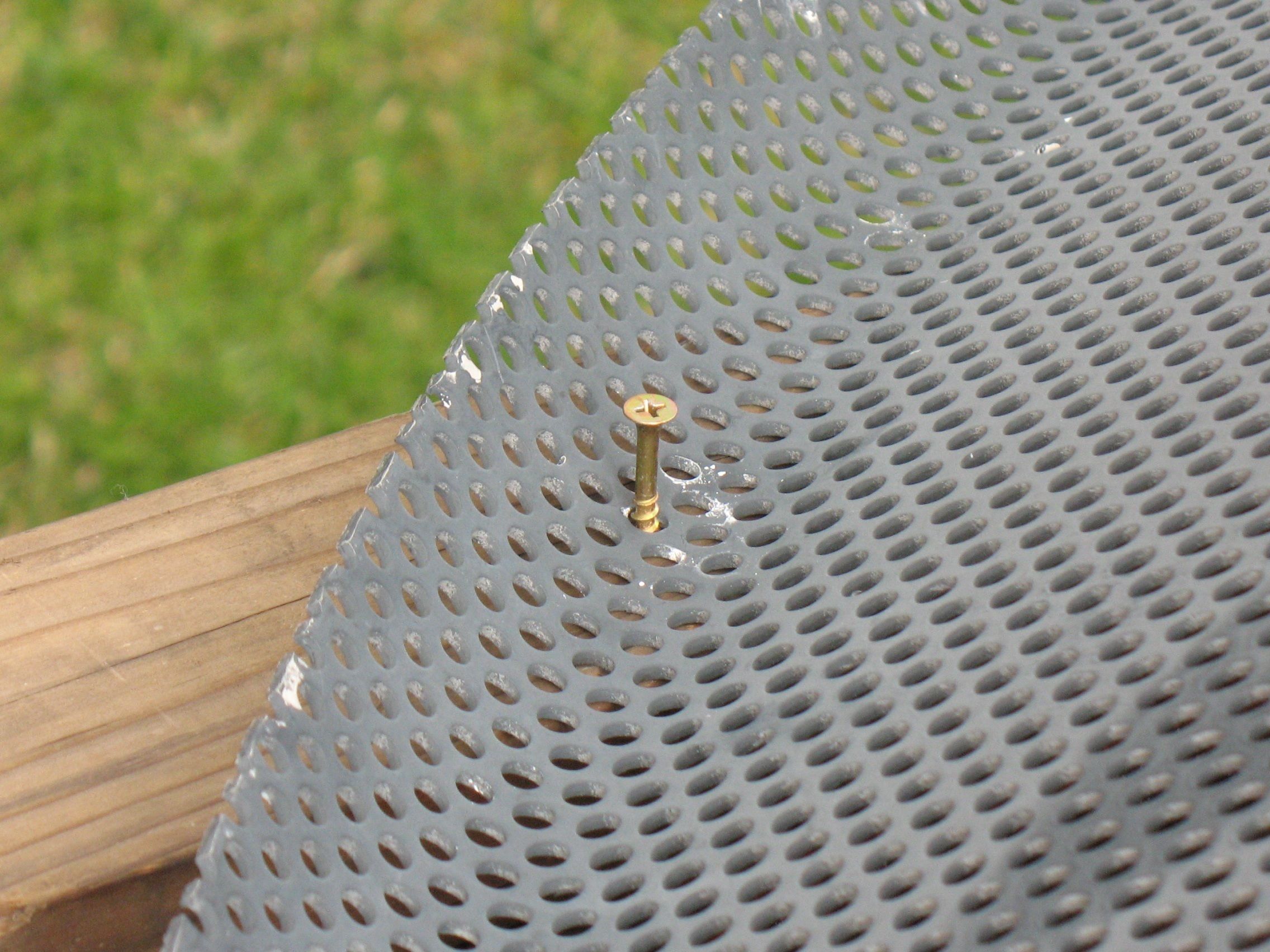

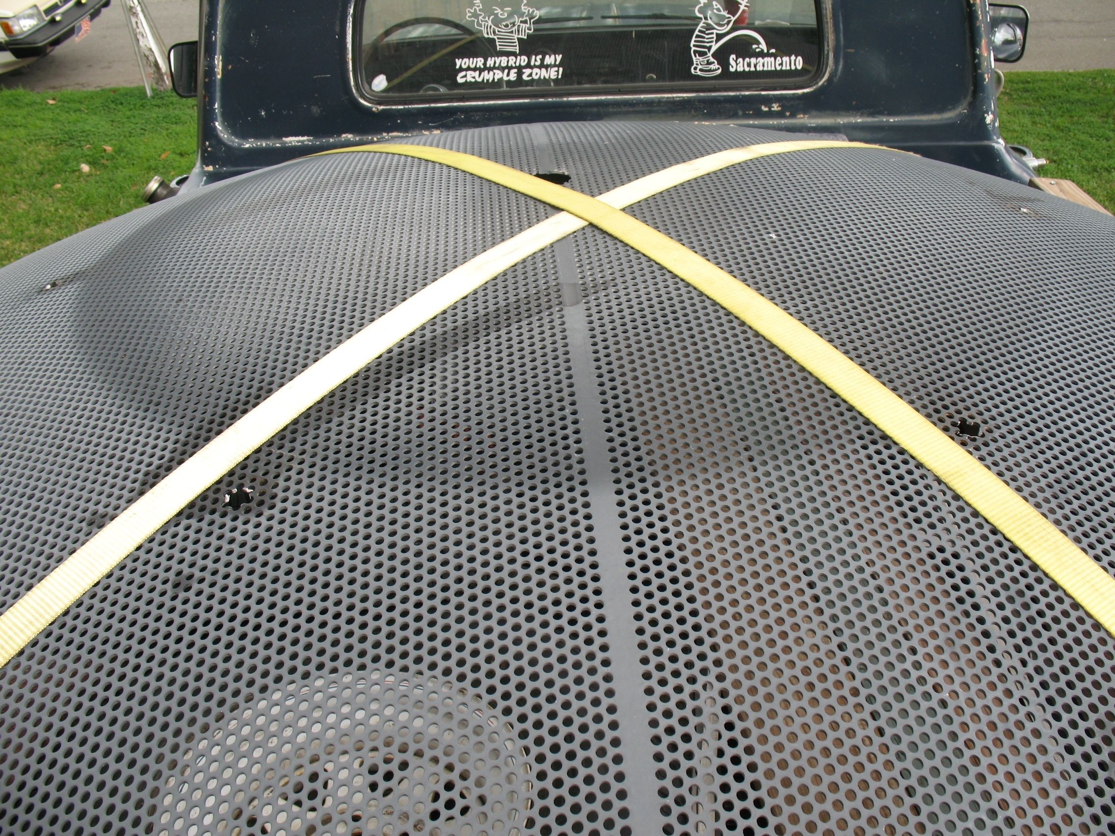

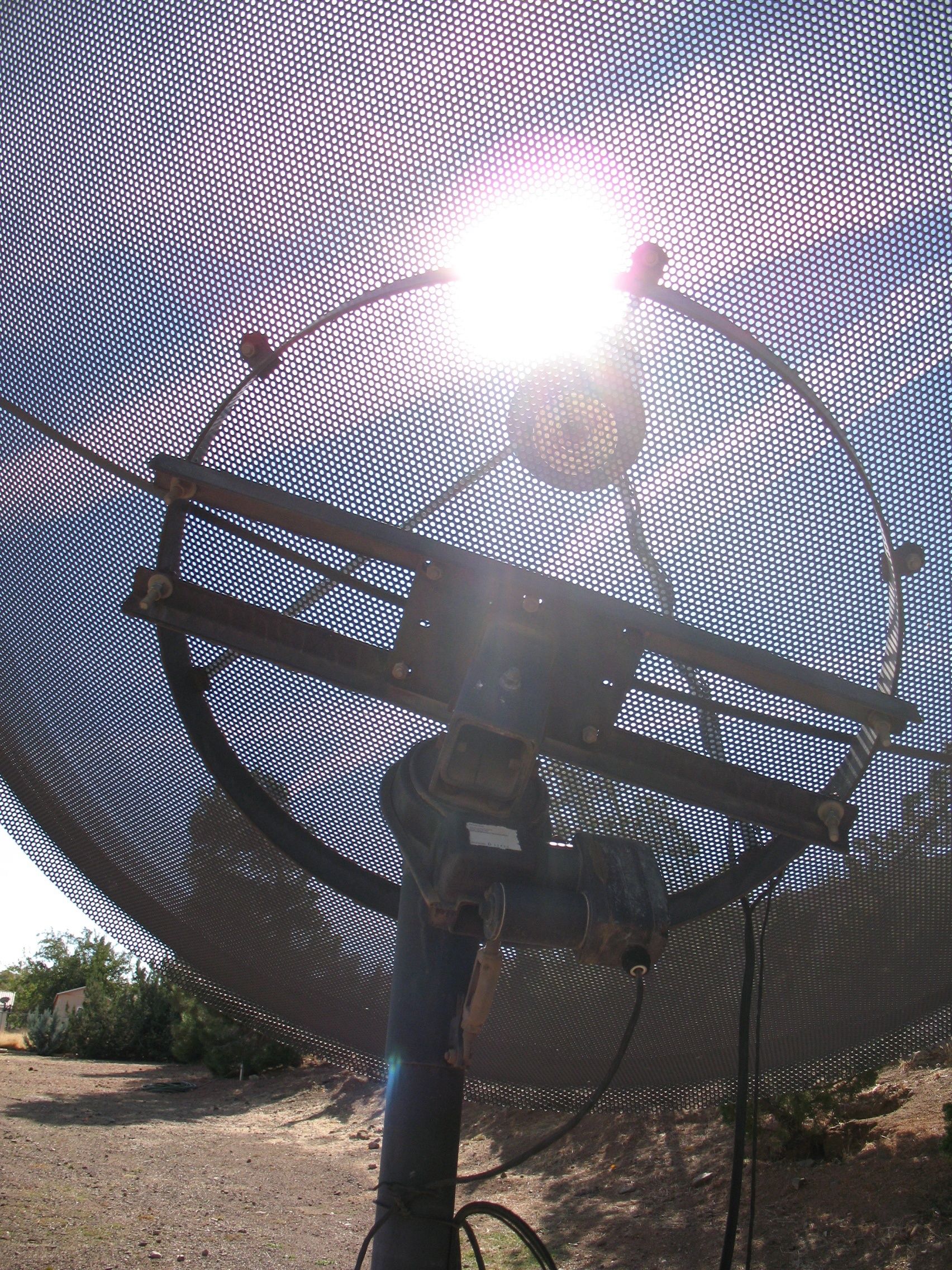

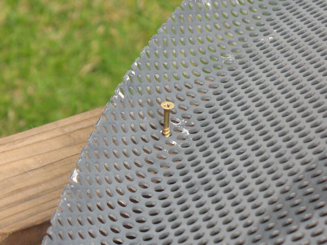

The DH dish my friend & I removed we started by spraying all hardware with PB Blaster(O'Reilly Auto.) While waiting for it to penetrate, removed the flat cable. Followed by unbolting the "milk stool" from behind the dish - 3 nuts. You'll have to see for yourself if the "milk stool" is bolted through ears on the mount ring on this one. I believe they will be. Then unbolted the dish from the ring - wrench from the front & socket/ratchet from the behind. Set that aside & then lifted the heavy, awkward HH mount from the pole. Strapped in the mount in the bed of the truck first then screwed the dish itself face down to 2x4s on the lip of the bed with deck screws. I had prepared two 8ft 2x4s with three each 1.25"sq. x 3" pieces to fit the stake holes of my old 65 Chevy. Gently but firmly strapped the dish down in a cross diagonally. The owner of the property wanted to keep the pole intact for a bird house.:)
Drove home by way of the 14 to 210 fwys, smiling & waving at the gawkers, some more friendly than others.:p
