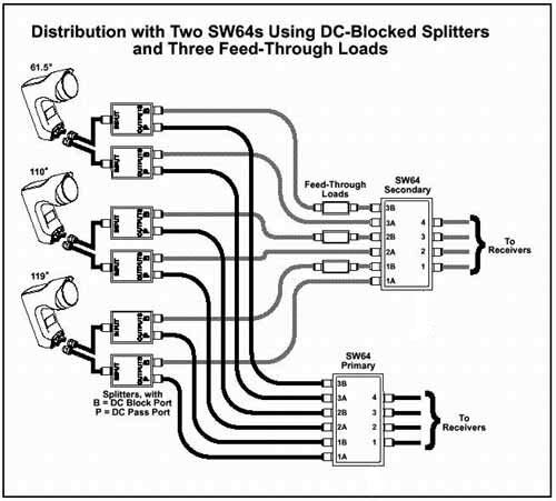

you can have two SW64's allowing upto 8 recievers.. I saw a diagram on dish's site once.. luckly I saved it :)

I was basicaly wondering how many dishes you could hook up to one receiver. I know Dish has many sats and I know most are for something called SPOT BEAMING?. living in Ottawa I know I would have access to 61,110,119,121 not sure if I can get any further out west of that.
So in my case I wanted to know what type of Switch I would need to get the 4 sat I mrentioned. Presently only have 110 & 119

Technically you can do 5 satellite slots at once with a DPP44 and a DP21 on one of the outputs.
The DPP44 would allow 4 satellite slots (110, 119, 121 and say 61.5) and allow 4 receiver outputs. On the output you could put a DP21 and add a 5th.
But from the sounds of it, all Int'l is going to 118.7 so most people would only need a 4 sat solution if they have Int'l and HD (110,119,118.7 and either 129 or 61.5)
