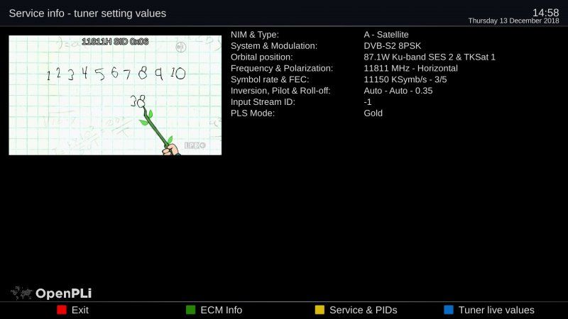

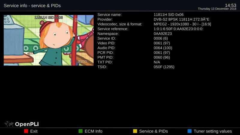

Here's an example of what this receiver does, which I find very useful for HD quality comparison purposes. Of course, it's more information than the common person could need or want, but I love digging into a video feed and seeing exactly how good (or bad) the quality really is. My eyes' perception will vary from the next person's, but the parameters don't lie :)
Would be AMAZING to have information screens like these somewhere in the Dish receivers.
