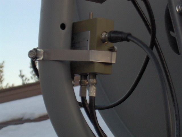

Turn the LNBF upside down for the cables and connections point up instead of down. You probably will need to fabricate a brace for the LNBF to support it, (like a L brace down the back of the LNB and along the arm of the dish) and some 90 deg cable adapters for there will not be so big of bend in the cables, and something for the cable cover does not fill up with snow and rain. (even cut off a pop bottle and stick it over the connections) There is enough offset to most dishes that the LNB should not shade the dish from the signal.

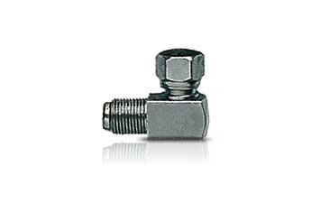

Only issue I am thinking is the cabling might block the signal. I’d have to either loop it out the connection, down the back side, then under the arm of the dish or make sure the cable doesn’t block the eye. (thing is right now my roof is clean of snow but living in MN we may get dumped on and then I’m screwed until spring)
well I went and got me some right angle rf connections from the Rat Shack. I had some but went and bought new ones and I found a better switch.
I have an old 4x2 Phase II switch...4 cables in and 2 out and I know that one works fine :)
Going to try it this weekend. I may not need to have to put the LNMB upside down. As long as I can get from 58-129 I'm happy (dont need 148 as there sint anything on there except Dish 101 and the Int'l promo)
If you find the right angle connectors still don't give you enough room, then you could always mount the LNBF at a 90deg angle. Just have to change all your horizontal settings to vertical and all your vertical settings to horizontal. (and a little duct tape to hold it all in place as well)

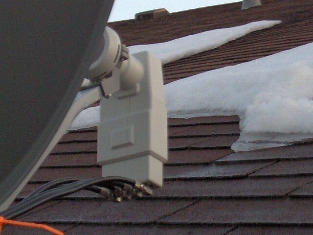

I got it working :)
wasnt bad here today....right around freezing but sunny
Got everything set up in the house. Put the 4 right angle adapters on it and tightened them down. Hooked up cables and hooked it to the 4x2 Phase II switch. The Circular went to the 22k on and the linear went to 0K..both outputs went to the 6000.
Then the test
93 (TS)..fine
91..fine
91 DBS...fine
went to 61 and had 2" of clearance :)
went to G10 and had plenty of room
went to 129 and had about an inch and half
couldnt get to 148 though...hits roof at 146
So its all set and working and it loks like signal numbers stayed the same :D

final result :)
Dont mind the brightly colored zip tie (I got like 1000 of them for 5 bucks) :)
