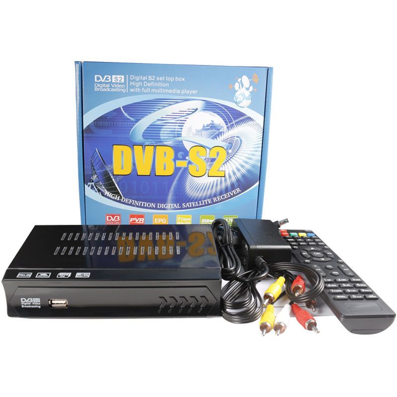

I was looking at one of these, looked like it is about as basic as it gets nowadays:
Full HD 1080P DVB-S2 DVB-S Digital Video Broadcasting Receiver Set Top Box HDTV
Any thoughts?
