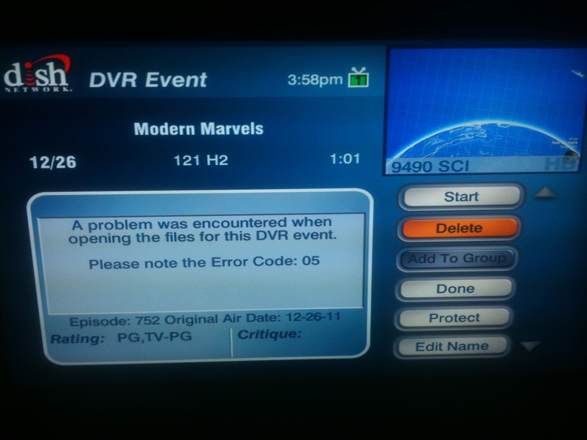

I tried to play a program from the internal DVR. I got this (& a black screen showing 0 minutes remaining):

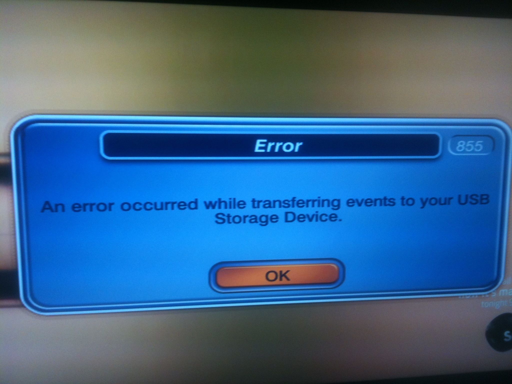

Then, while trying to move items from the DVR to a new, known good 1TB EHD (WD Expander), I get this:

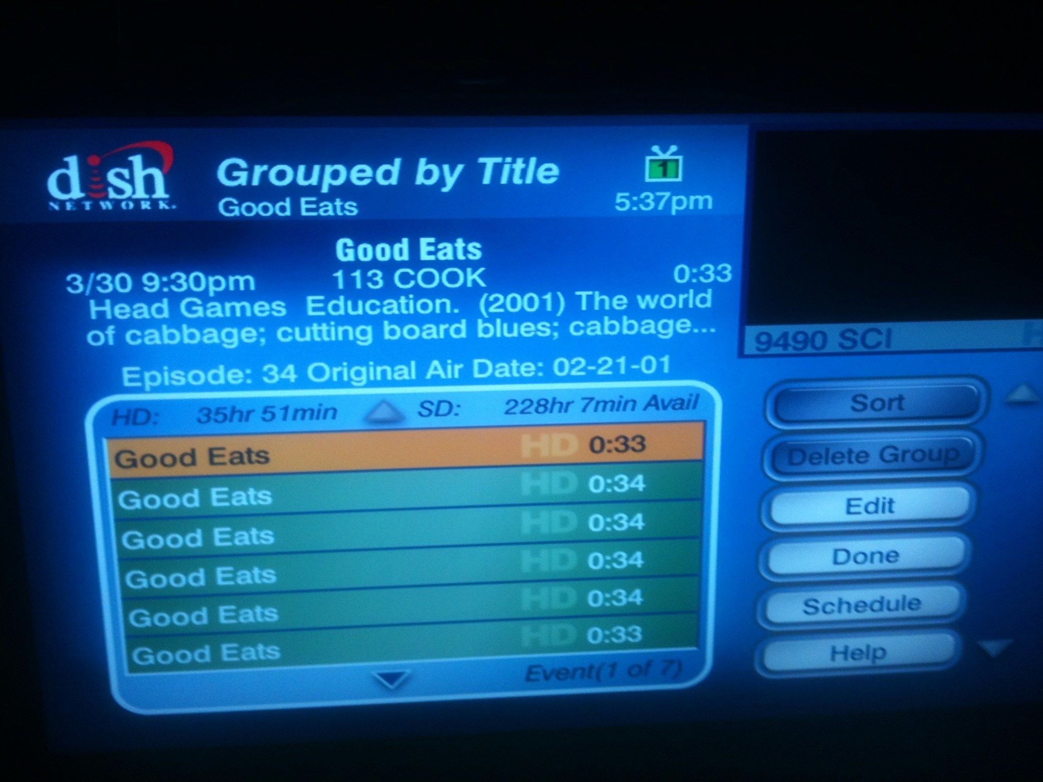

So, putting on my Sherlock Holmes chapeau, I started playing different titles. For this title, which looked just fine before trying to play it:

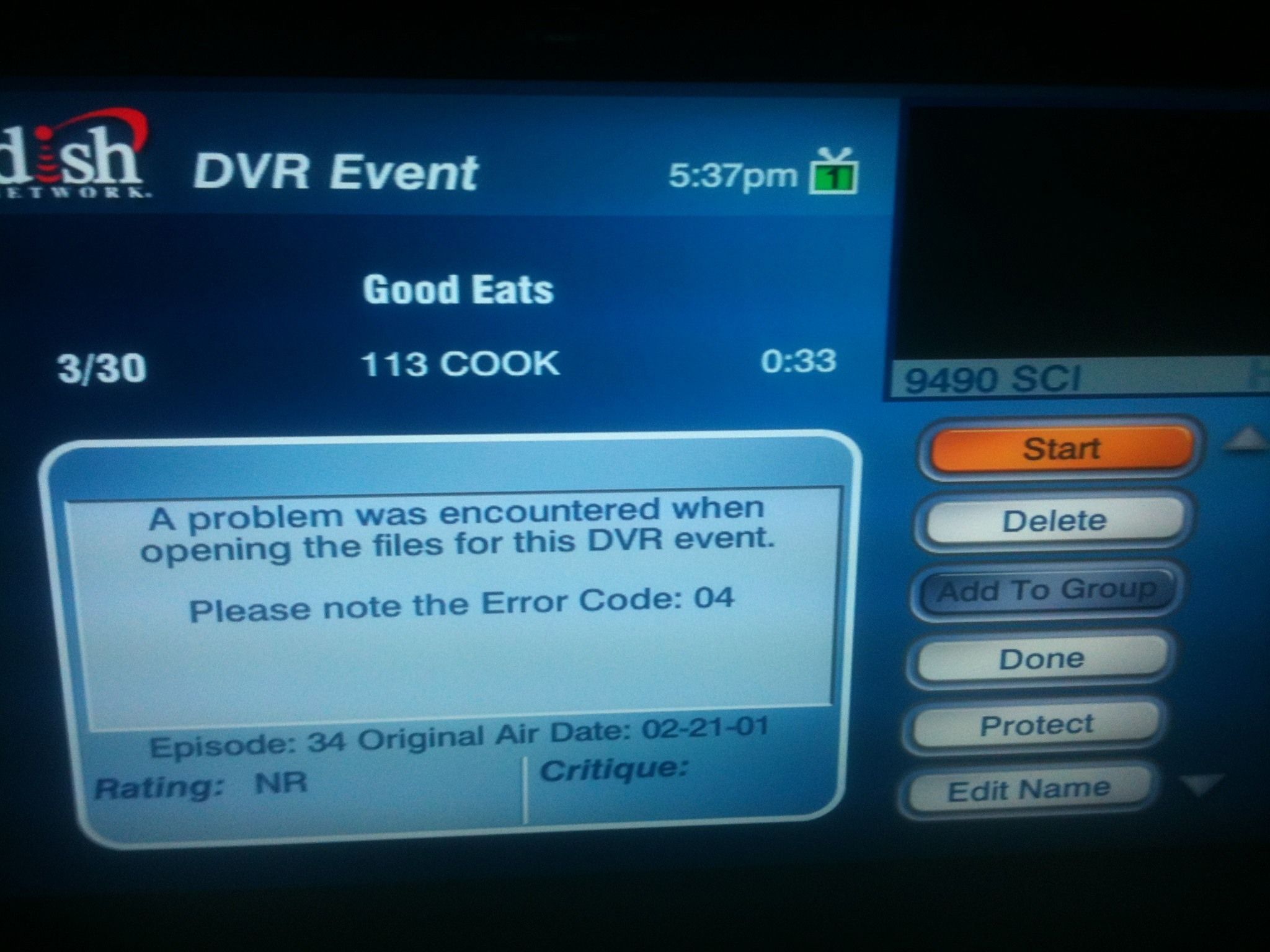

After selecting it to play, I get this:
Please note that the error code number is 4 on the last screen, but 5 on the first, but it is the same error message.
Anyone able to explain what is going on? It sure looks like the DVR is failing. I'm trying to move to EHD everything I can, but the process keeps failing, per the above. Maybe I need to PM the DIRT.

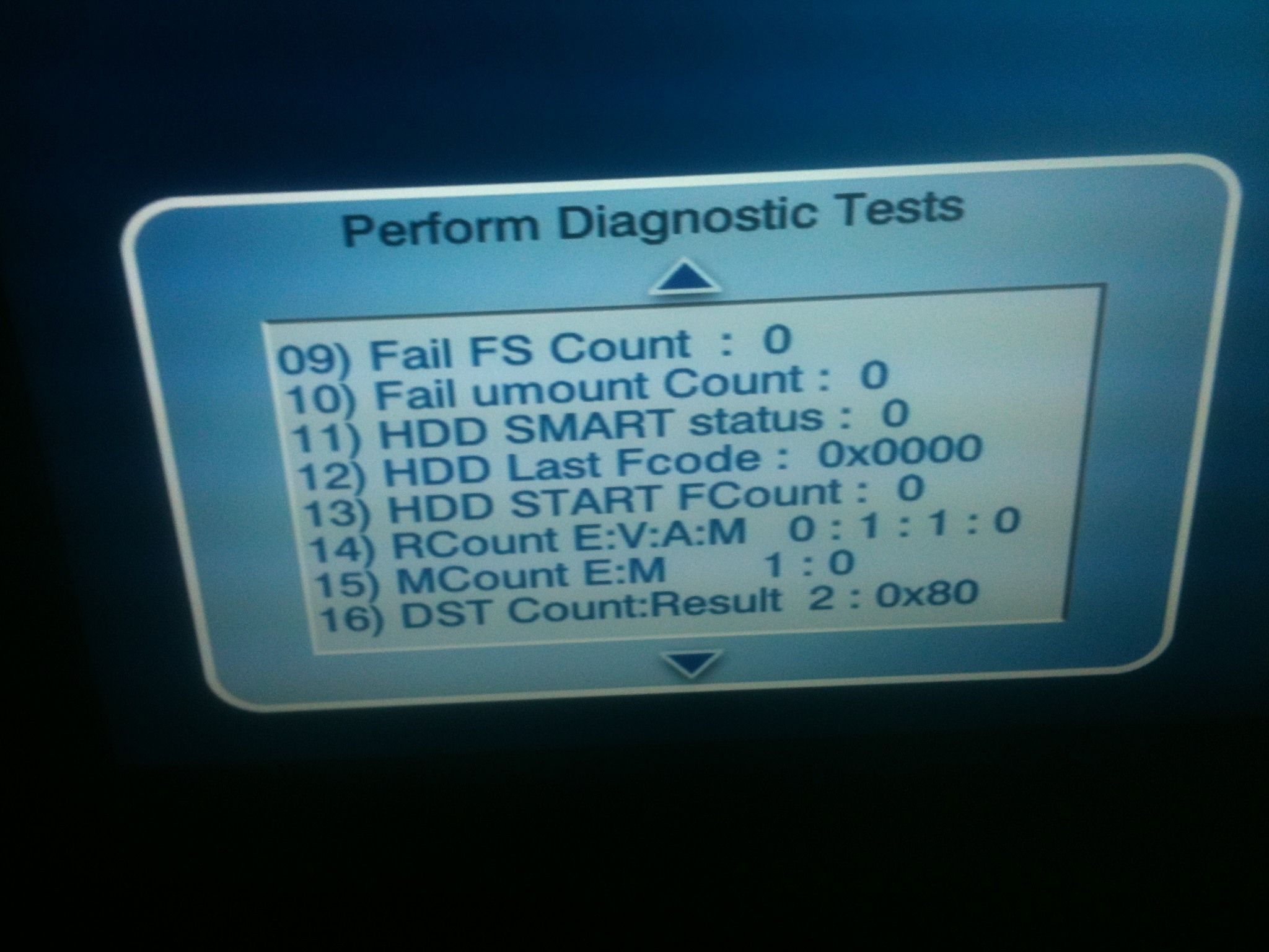

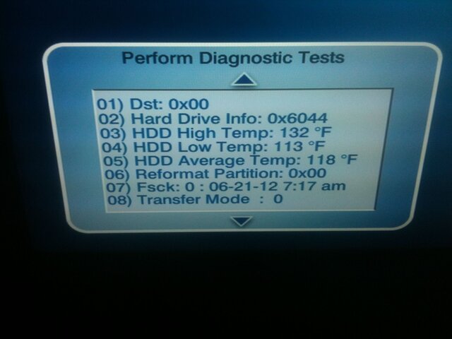

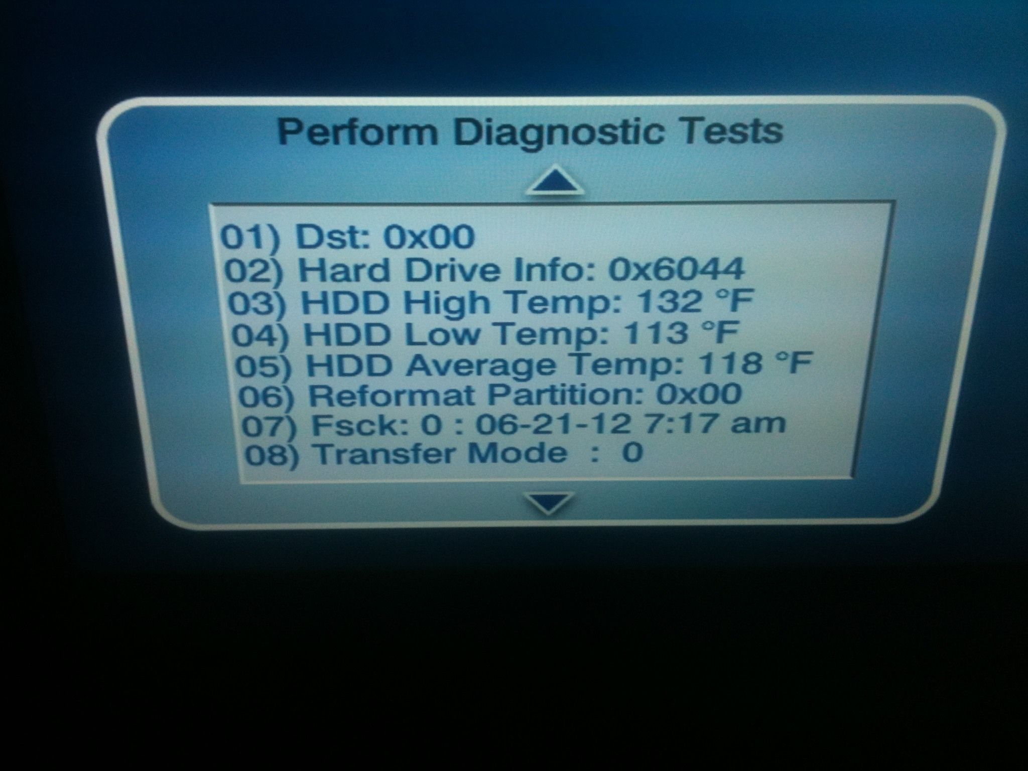

Try MENU - 6 - 3 - Counters, scroll down to where HDD temps are, what is your "Fail FS Count?"

With "Fail FS Count" being zero, then that means that the DVR's checks haven't found any evidence of HDD corruption yet. Tried a power cord reboot?
