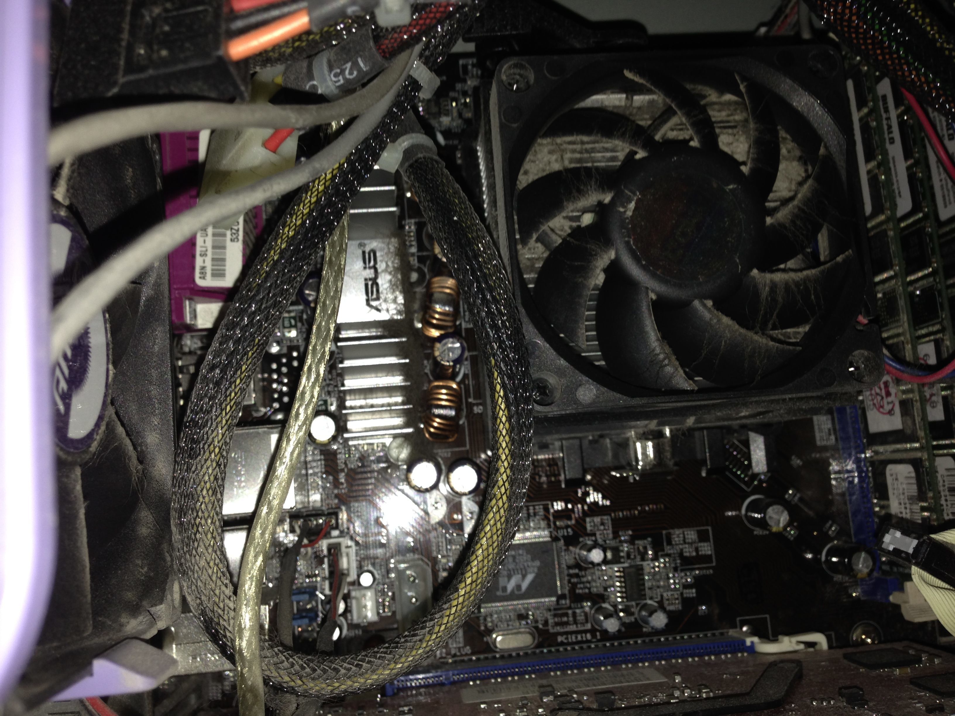

I have an XP Pro machine, taken from service some years ago, fully functional at the time. I recently turned it back on, to convert it to Linux Mint, and got - nada.
Opened it up. Green light on motherboard lights up. Front panel power button has no effect. Thinking the switch was bad, I jumpered the spot on the mobo where the sw plugs in. Nada. No reaction, no sounds, no fans, no HDD spinups.
The motherboard is an old ASUS. Oddly, I can find no model number, not even after removing cards, but I believe it's older than the A7N8X. PS is a PC Power & Cooling Turbo Cool 510.
Any ideas before I pull the CPU & RAM and go looking for a compatible mobo? Any idea on what to try to bring this back from the dead?
Yes, I need to clear out the dust bunnies.

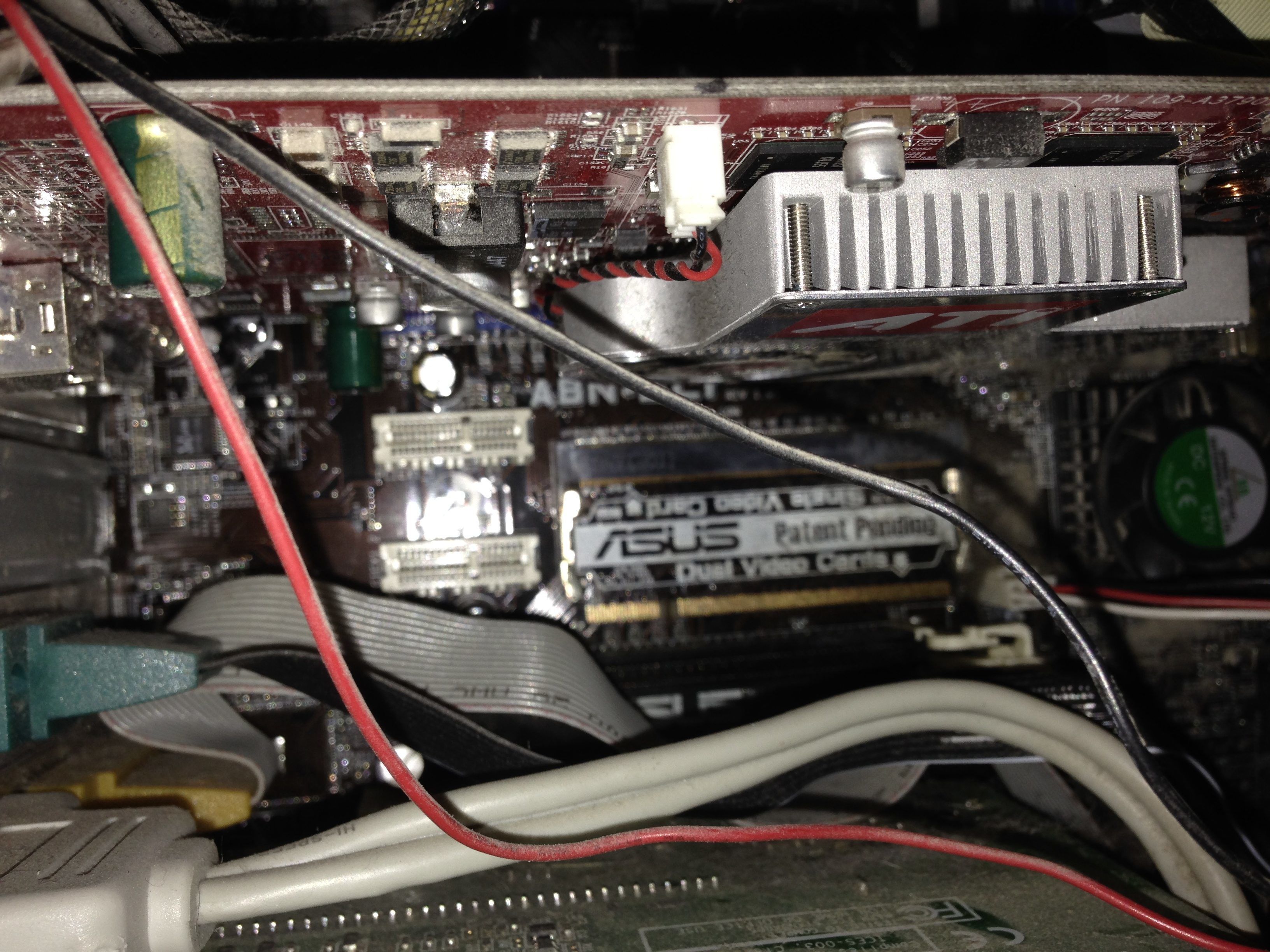

If it is any consolation, I had an Asus P5B-VM that just bit the dust. I'll take a look at your pictures and see if I can see the model number. Asus usually puts the model number between RAM and CPU socket.
EDIT. Right there in the picture... A8N-SLI. ;)
It is going to be hard to find a decent NEW replacement since the CPU and RAM is old-school. Since it is an nForce4 board, I'd probably start by pulling out everything but one stick of RAM, the main hard drive, and any video card and extra cards in the slots. Leave the video card in IF your motherboard doesn't have the 6200 on-board graphics. I believe the one with on-board was called nForce4 IGP. See if it will boot with minimal hardware in it. In cases like this, a lot of times I will head to eBay and look for a cheap exact replacement. Not many things you can do if you can't get through POST.

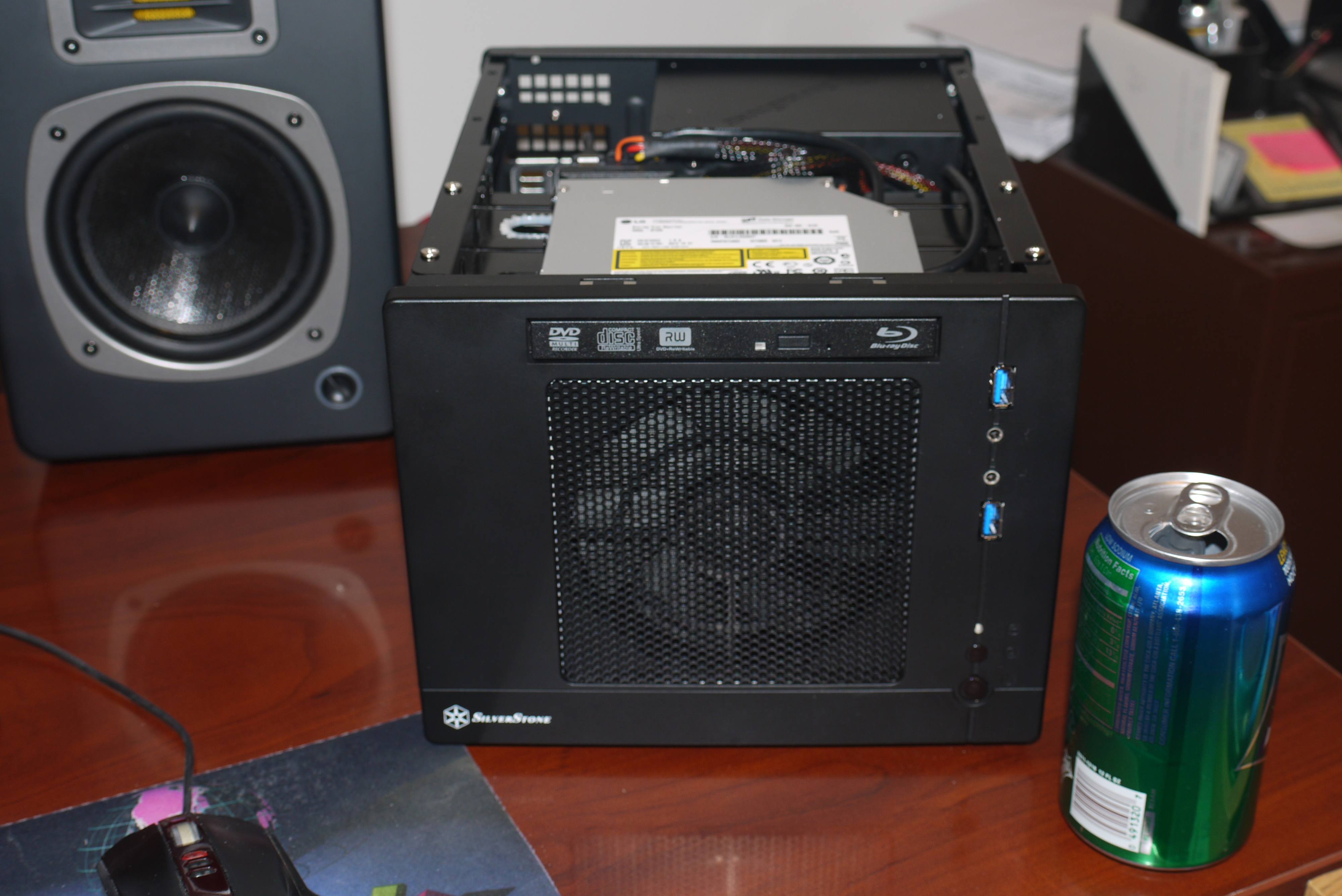

When my P5B-VM died, I just decided to build this little guy. A water-cooled 4th Gen Core i7-4770k with nVidia 760 ITX, 16GB DDR3, 2x 750GB HD, 6x BDXL writer in a case 7" x 9" x 11".

"When my P5B-VM died, I just decided to build this little guy. A water-cooled 4th Gen Core i7-4770k with nVidia 760 ITX, 16GB DDR3, 2x 750GB HD, 6x BDXL writer in a case 7" x 9" x 11"."
Nice. And we both like Sprite. But right now, I have to do this as close to $0 as possible, or not do it.
