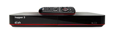

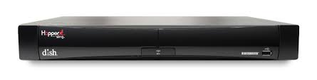

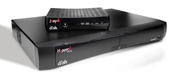

You keep mentioning "dual DVR." If you have a Hopper 3 as stated you have 16 tuners. Hopper 2000 and Hopper with Sling have 2 tuners. You can tell which one you have based on the following photos or simply going to the diagnostic page (Home, Home, Home on a 54 remote) or ( Menu, Menu, Menu on a 40 remote) and look at the top of the page and it will tell you exactly which model you have.
Hopper 3

Hopper with Sling
Hopper 2000
